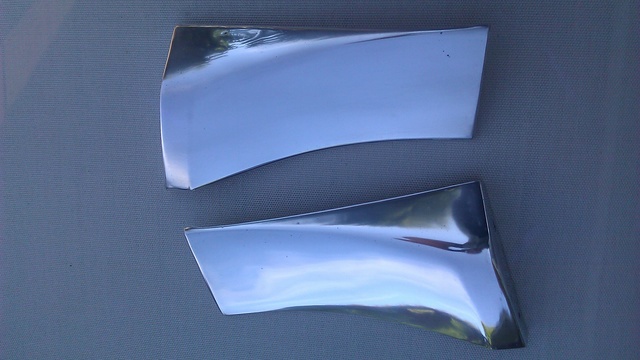

Well...I did discover for myself the time and mess that comes with stripping off the anodized finish in order to remove the road rash before polishing. Out of sheer curiosity, I tried refinishing the two lower fender moldings (behind the front wheels) that I had laying around. Lots of hand sanding and subsequent polishing. Got all but the deepest pits out and they shined up like new. So now, I have a set of these that I have no use for. If anyone is interested in buying them and saving themselves a lot of work, let me know.

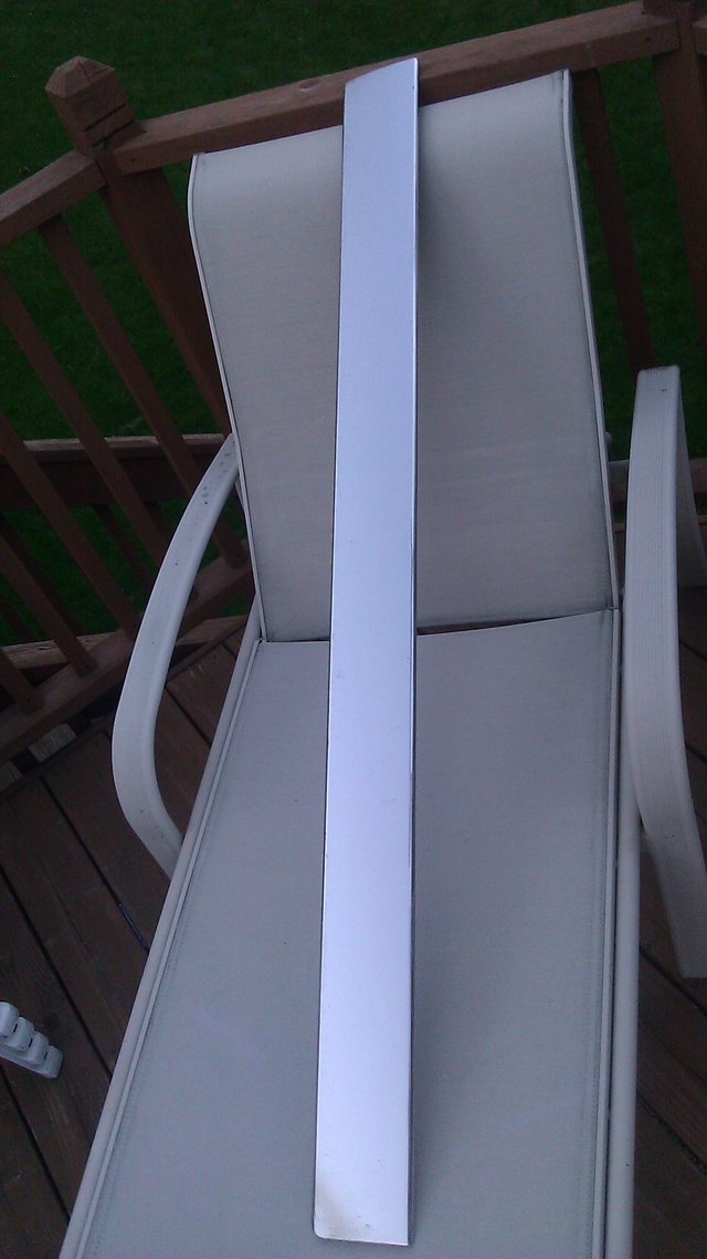

I also have a nice driver side lower door molding I pulled off a '75 Malibu from AZ if anyone is interested. Best one I've seen on any cars I've come across...with no significant dents or deep scratches. Right now, I have no desire to commit to the time required to restore it like I did the front moldings. Maybe if I were going to install it on my own car.

Wow! Better than new! Nicely done! You found a new side job.
