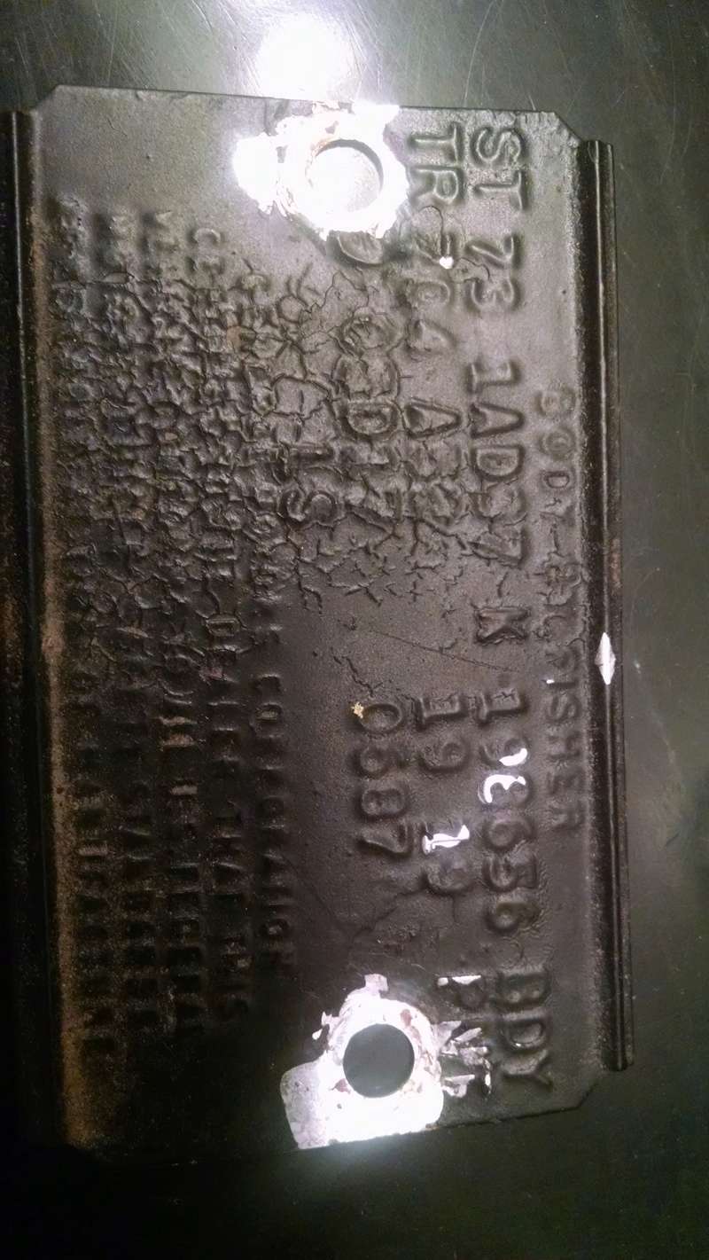

Can you guys help me so I will know exactly what I have....thanks..... Scott My 73 vin decode Img_2026

You mean Trim Tag Decode. VIN is on your windshield. That tag is on your cowl.
Starting on the top row.
73 model year.
1AD37 Chevelle sport coupe
198656 Body sequencing code (if I remember correct)
704 Black oxen fabric interior
A52 Bench seat
19 Tuxedo black exterior upper
19 Tuxedo black exterior lower
03D17 03D build date of March, 4th week. (17 is unknown)
0687 sequencing number used at the plant.

Thanks man.....I meant trim tag.....

No SS designation on the trim tag and no engine designation on the trim tag either. Just basically exterior and interior color, bench or buckets and build date.
Best way to check for original engine would be with the stamp on the pass. side of the block right behind the alternator. The last six digits of your vin will be there and three letters. The six digits have to match your vin to be numbers matching. The three letters will tell you what trans came with that engine originally.
