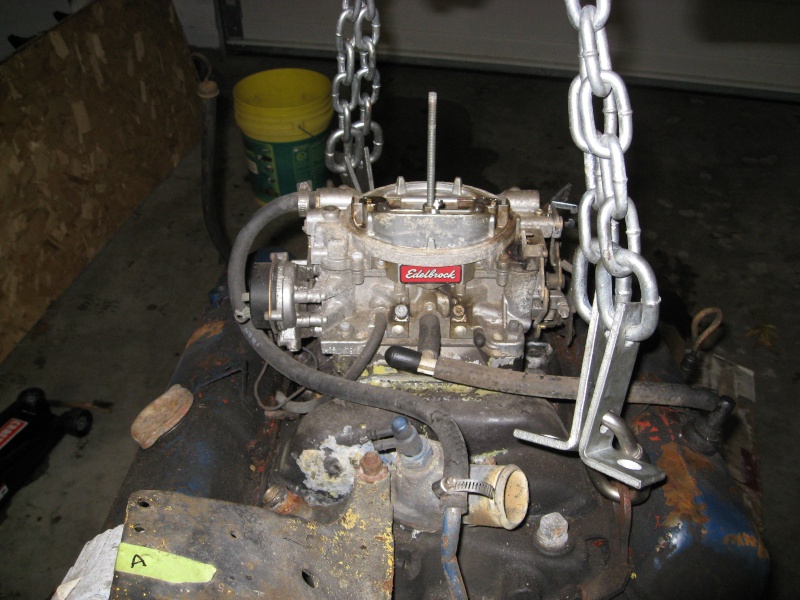

![Pulling the engine tomorrow!!! Img_0011](https://i.servimg.com/u/f82/13/82/05/93/img_0011.jpg)
![Pulling the engine tomorrow!!! Img_0012](https://i.servimg.com/u/f82/13/82/05/93/img_0012.jpg)
Done!!! (well, almost.) Now, where's a good place to get new stuff? What kinds of things do you suggest getting?
