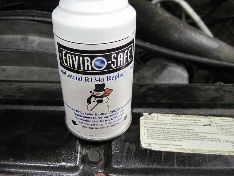

Well I just ordered 1 can. It just took me a while to figure it out because on their website and on the can it just says R134a refrigerant and says nothing about being compatible with both 134a AND r12. I had to read the customer reviews on Amazon to see that a lot of people used it on their old r12 systems. Since my AC system was working fine before, except the slow leak out the front compressor seal, I guess I'll just try adding a little of this and see if it works. Should be here next Wednesday. It was only 7 bucks for a 6 oz. can (equivalent to 16 oz HFC-134a) so I don't have much to lose by trying it out. Better than 25 bucks a can or more for r12.
Oldschool454- G3GM Member
Re: r12 to 134A
Just make sure when you install it, that the can is inverted as per the instructions. Also, the cans are setup to work with R-134a gauge sets so you'll need to install adapter fittings on the low and high side valves for proper charging. I forgot to mention they sell an "industrial" version which works better than the original blend which is what I've been using the past couple of years. It typically runs about 10 degrees cooler depending on the ambient temperature outside.

So I got 4 cans of enviro-safe refrigerant a few weeks ago and added 2 cans to my empty system after my r12 leaked out. I've been driving it pretty regularly since then and it's been blowing not quite cold but cool enough to know it's working. Which is a huge relief. My question now is how much will the system hold? I know if you convert to 134a the system uses less so I'm not sure about this stuff. I don't want to just go off of what the r12 label says and end up overcharging it.
Re: r12 to 134A
Your system when completely empty will hold 3 cans of Enviro-Safe refrigerant. That should get you the temperatures you're looking for.

Well it's been a week since I fully charged my A/C system with 3 cans of the enviro-safe stuff and it's been blowing close to ice cold! The wife and I went for a drive on Tuesday when the temp was in the mid 80's and she asked me to turn it down because it was too cold. lol love it. That stuff really is a good deal. In addition, I remember how much the engine would bog down when I turned the ac on before with straight R12. And this stuff doesn't seem to put nearly the amount of drag on the engine. Still just a little noticeable but not nearly as bad. Just saved me a bunch of $ and time from not having to convert to 134A.
Re: r12 to 134A
I was very skeptical the first time I ordered this stuff over 25 years ago. I am certified to purchase R-12 but the cost got out of hand. Also heard many stories of converting to R-134a that did not turn out well. So I took a chance and was very impressed when I installed it on my dads New Yorker as my first experiment. Been using it in all my g3's since then. So glad it worked out for your project. It just seems like the best alternative to R-12 since its efficient and does not harm the environment if it escapes from your a/c system. Enjoy your "cool" summer!
