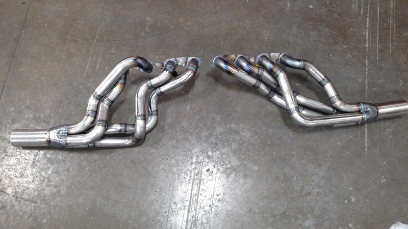

I ended up going with a set of Lemons headers. They're freaking beautiful. Costly, but amazing. They're 2 1/8" primaries into 3.5" collectors. I called Dan and he said he did a 74 El Camino a while back and had the jig for it. So, we started there, and he tacked up a set and sent them out. They pretty much hit everywhere. So, I cut, marked, photographed, diagrammed, and sent them back to him. He made the requested changes and sent me Rev B... Still hit in two places and I wanted them tighter to the floor, so I went through the same process and sent them back. Rev C. came back to me and they were perfect. So, back to Dan they went and he fully welded them up. They are by far the easiest headers I have ever installed slide right in and out. They tuck up super close to the floor and don't hang down at all. My only regret is that I can't really see them with the procharger and intercooler piping!!!

Those are beautiful..... Your entire car is amazing. Looks like you have plenty of frame clearance now. I think it was the tube for cylinder #6 that comes close. I see that one is kicked up out of the way. Nice work..

I'll trade you 1 Trillion gallons of water for those Lemons headers. That's how much is around my house now. Those are so cool.
