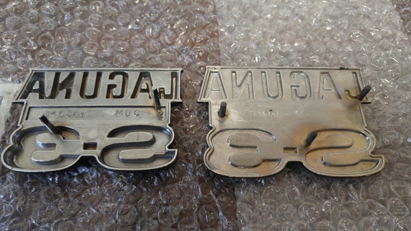

When I got this '76 S3 went through all the stuff in the car, found 2 of the tags that go on the emblems (see picture).
As far as I can tell there should only be 3 S3 emblems on these, one on the grill and one on each fender?
So I see how these tags go on the emblems, the 2 I have need some work, the clear covering on mine have differing issues. One has some type of black on it, maybe spray paint? They both have a rough exterior finish which could be from time or maybe some sort of caustic such as lacquer thinner? Any ideas on how to refurb the exterior?
Anyone know if anyone repro's these? I still need another one, or maybe 3 to replace all of them.

The rear panel emblem is maybe 20-25% larger than the grill emblems. There should have been three mtg holes between your right tail light and the license plate.
Re: '76 Laguna S3 emblems
Here's a side to side comparison of the fender emblem with the rear panel emblem. You'll notice that the rear emblem on the right is slightly larger but thinner than the fender emblem. It also has 3 mounting studs where the fender emblem only has 2 which are longer. Hope this helps.

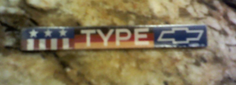

Had some time today, took one of the emblems and polished it, the one without the black stuff on it, started with 400 grit, then 600, then 800, then used Mother Plastic Polish, turned out great. Picture does not do it justice, only aspect is the backer and the clear cover has a few spots along the edge that are separating, you can see along the lower right edge....still have the other one to do, still looking for 2 of these if any one has extras!
