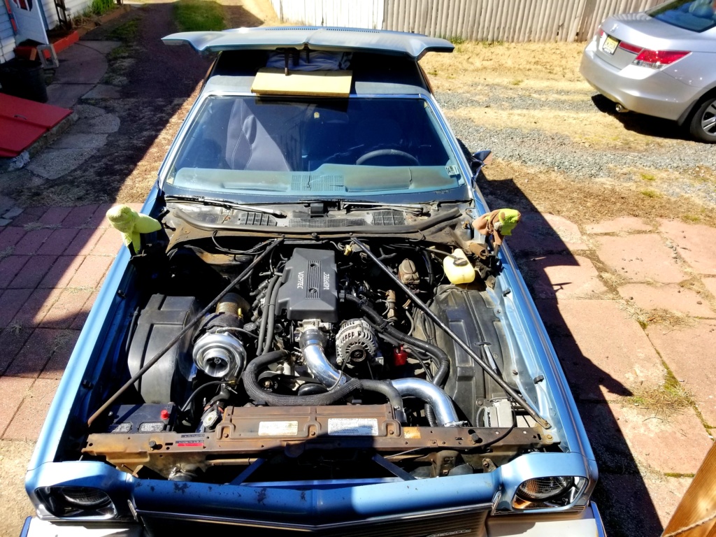

Havent been on here much recently, but i did get the 4l80e in the car with only very minor issues. No problems with room in the trans tunnel, just massaged the pinch weld slightly to make it easier to get to the bolts. The G-force crossmember worked out beautifully, well worth the money IMHO. Making the cooler lines took more time than anything with having to try to keep the lines away from the heat of the turbo, I used 3/8' NiCopp line (cheaper and easier to work with than AN lines). Also had a 3.5" driveshaft made locally.

I cant answer that as my car has a turbo LS in it, but maybe someone else can.
