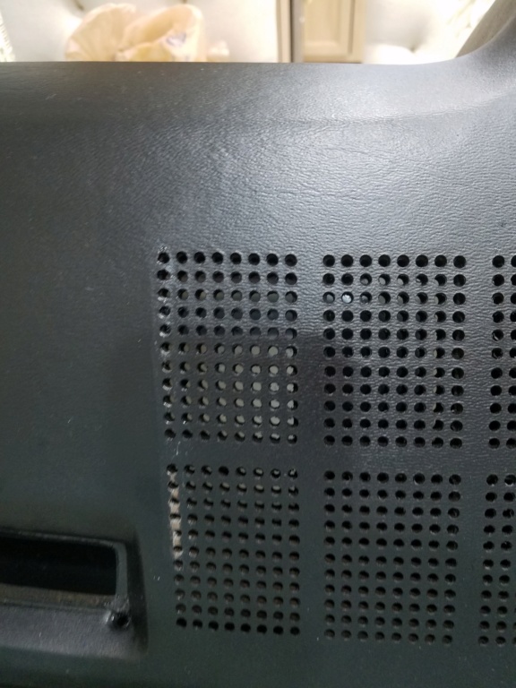

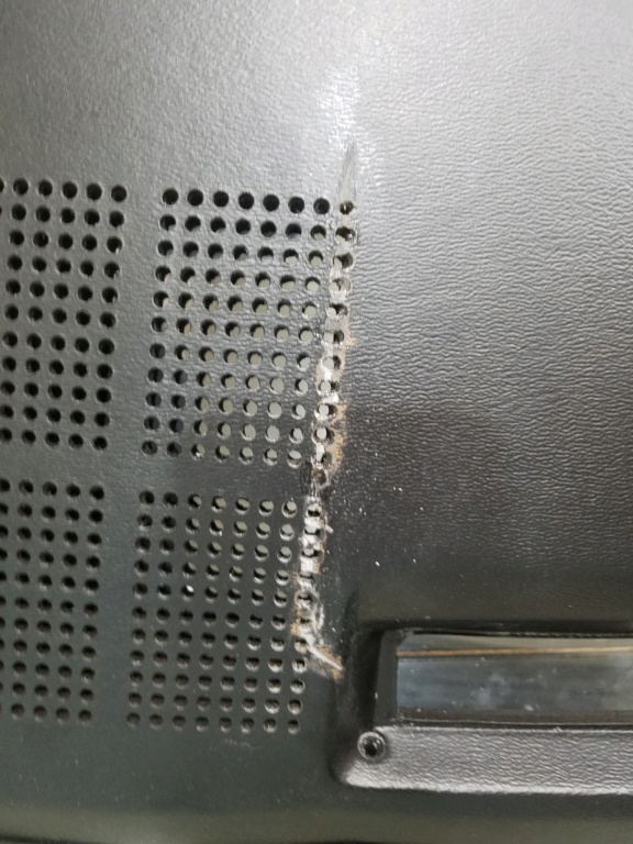

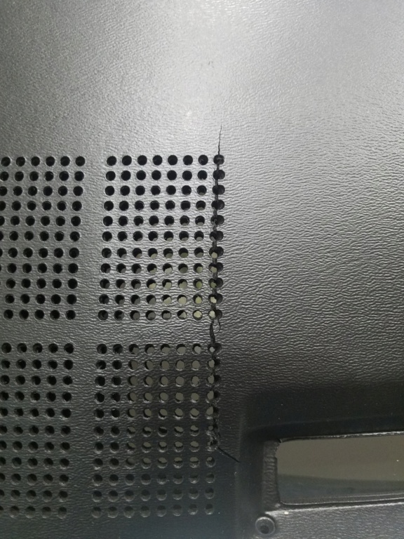

I've read a few threads on other forums about fixing a dash pad but those seem to deal with badly cracked dashes. The gently used dash pad I picked up has some small cracks in the speaker grille area and small crack leading to the drivers side defrost vent. Before I dye it I wanted to see if there are thoughts on fixing the cracks and what products to use.

I too had a similar issue. But on the passenger side. I went to O'reillys and picked up a two part epoxy...Veratex(?)
Anyway , used to patch and then sanded. In the case of the holes at the speaker grill , I was sure to be light with the application. Then as it slowly started to set I used a drill bit of similar size to " clean" the hole of the epoxy ( the drill bit not attached to the drill...but used by hand) . Then light sanding over the surface of the crack and more cleaning with the drill bit.
Then the dye process. Unrecognizable that a former issue existed.
Another option would be to tape off the line of offending cracked holes from those to the left in your picture. Then fill all the cracked holes in that line making it a stronger repair. No one would be the wiser that the row of holes were missing... once finished.

I made a little progress on the dash pad repair. I used JB Weld Plastic Body Panel Adhesive 50139. I think it came out decent. I have a couple more touch ups I think but for the most its ready for paint.
