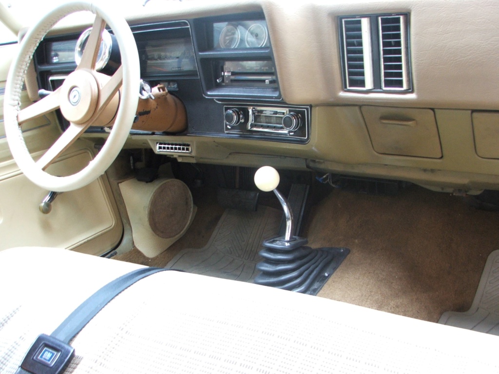

![steering wheel cleaning Dscf4110](https://i.servimg.com/u/f49/14/35/09/33/dscf4110.jpg)
Here's another view of my steering wheel and shifter Mcarlo77. It sure does fool a lot of people. haha
I did the soak it hot water and scrub the heck out of it Dawn dish soap trick first. It came out "OK" but it still had a little sticky feeling to it. I also didn't like how the wheel felt on the small size, so  I wrapped it and love how it feels now.
