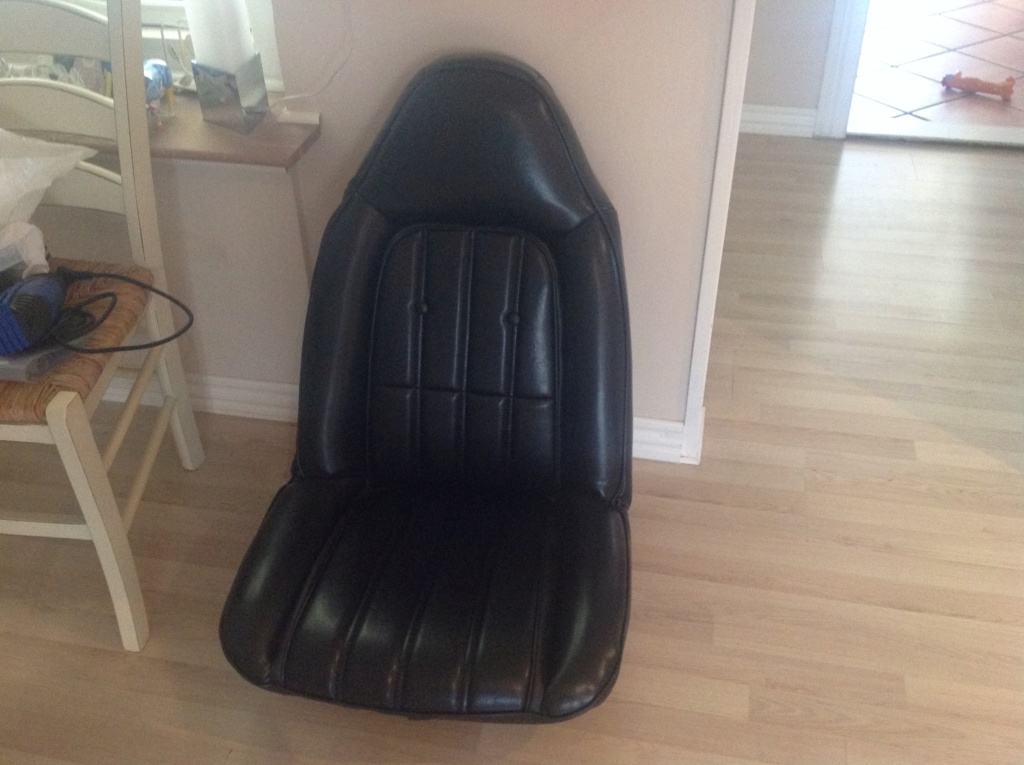

seatcovers Image11Hi guys. I just restored my swivel seats with covers bought from upholsteryguys.com and they are wery good quality and afordable. They are wery easy to work with and look wery good. They are Way better than the ones i Got at opgi, they only lasted 2 years before ripping at the seams. These look like alot better quality covers.

Im wery happy with mine. Im told these should be the hardest seats to upholster. Im sure they are cause it was not easy. I Found out i would have been better off with new foam. But its expensive and almost cost more than the covers. So i glued some 2 inch foam on the old foam with spray glue. I took some 5 inch foam too and put in the sides. It worked fine as long as the covers are streched out everywhere. Then it was just a matter of wrapping it around the edge and putting the vinyl u Channel strip on. However i had to remove some of the foam that was on the new covers from the edge before wrapping it, or Else the edge would be to Thick for the u Channel strip to be put on. I Found that Holding it wrapped with duct tape was the best, that Way i could move it if it startet to wrinkle. I startet the wrap from the headrest and worked my Way Down. When happy i pressed the u Channel on with a hammer from the bottom  working my Way around. Worst please is the piping at the headrest Seam. But there is a cutout in the steel lip that it fits in. It took me 4 hours pr seat and is by far the worst seat to work with i have ever done, but patience and the quality made it look good in the end. Also i hung the on a chair close to my fireplace a couple of days so they were Nice and pliable to work with. They had fortunatly not ben packed tight in a box for long, so they had almost no wrinkles unlike most others i have tried. It can be done if you just use patience, and there is also a video on utube that shows how. Im happy with the result but next time i buy new foam also.

Your patience definitely paid off. These seats are very tedious to upholster for sure. I thought I would have an easier time with new seat foams. But like you I had to use additional foam and filler in multiple places to make them look right. It's not something I'd do for a living. My hands were sore for days afterwards. But because of a poor experience using an upholstery shop to install my first set I decided I'd keep the money and do it myself. Love to see your seats when you get them installed in the car.

Looks like a factory job -- nice work!
