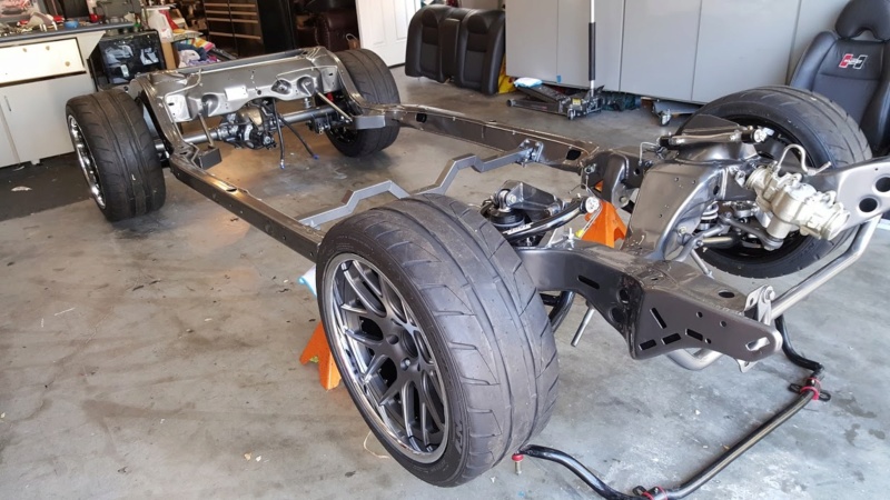

Here's another great demonstration that yes, there are significant differences on the 73-77 cars, and yes, we need to be really careful when we measure up for tires and wheel fitments on our cars!
This guy has a 73 Pontiac Grand Am. Front wheel/tire is 19x9.5 with a 275/35/19, rear is 19x11 with a 305/35/19. While I prefer a bit more sidewall (personal preference only), it does show what can fit on some of these cars with zero wheel well modifications. Also of note is that this car has Nitto tires as well, which seem to run a little smaller than other brands (or are the other brands bigger than the Nitto? LOL).
This is undoubtedly one of the better, if not the best, looking Pro Touring style 73-77 G3's that I've seen.

Yessir. That's where the pictures came from. Seth Rich has his build there as well, 73 Chevelle/Laguna. It's called Project Bad Buzz.
