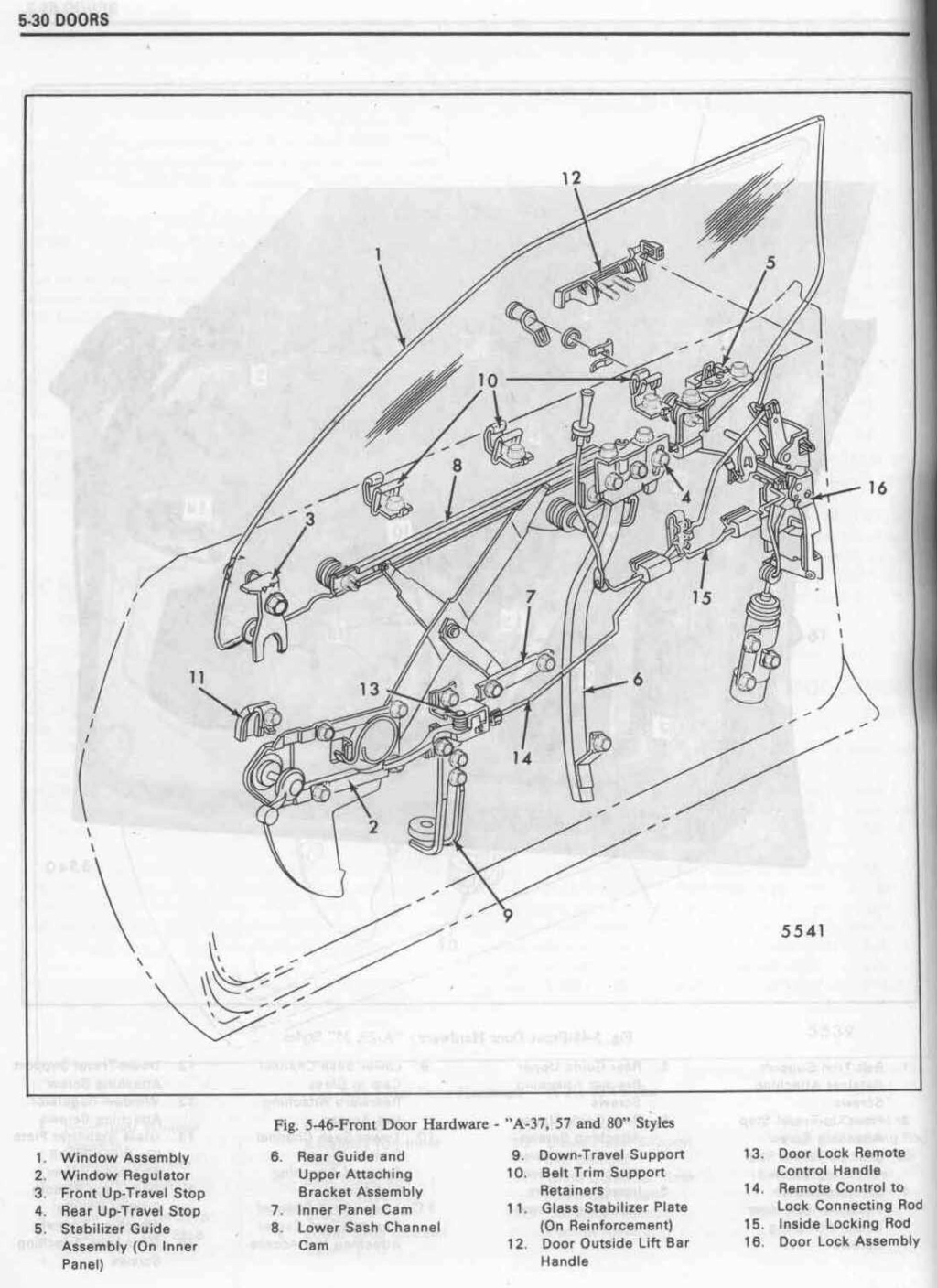

Not really sure on that. I would try sliding the shoulder roller down in the vertical track (#6 in the pic) and see if it moves freely all the way down. If it doesn't fit, I can send you a track from a 74-77 door if that would help. Here's some pics from my 75 Fisher Body Manual that shows the exploded diagram but it doesn't detail the roller.

Post by Joe73 Mon Sep 06, 2021 7:56 pm
I was just looking at the same pics in my fisher manual. LOL. I appreciate the offer on the track but I'll be staying with mine. Im waiting for my Dorman roller to come in so I can see if it matches. My roller is ok, but since I have it apart I'd like a new roller.
