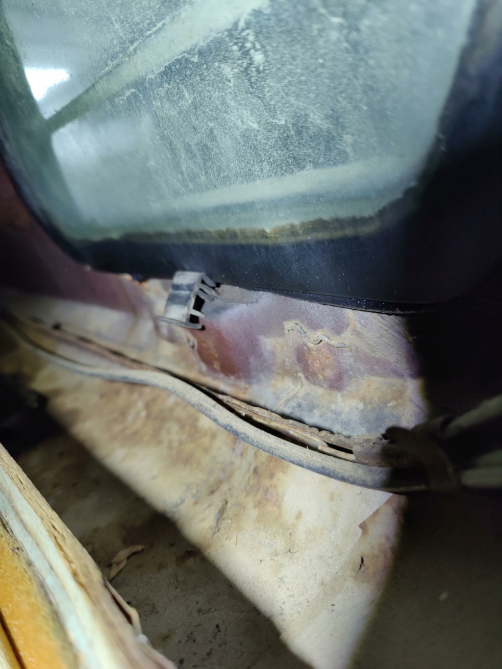

Need a little help with installation. I can`t find any of the plastic retainer clips that hold the glass in. What have others done to improvise in place of the clips ? Also what to use for adhesive and seal ? Thank you.

Jerry, if you use the "Window Weld" urethane adhesive that comes in the tube, you really won't need these clips once its cured. If you use the "butyl" ribbon sealer or rope seal you will need these to hold the glass in place. How many clips do you need? I may have some in my stash.

If I remember right, I think they take 4 or 5 of those clips. And yes, you can use the window weld on all the windows. It cures hard unlike the butyl type adhesive which stays soft. That's why I think GM use the clips on the side windows to ensure they wouldn't come loose. I'll see if I can find these clips in my shop over the weekend and let you know.

Here are some pics of my parts Laguna with the clips. There are 6 clips total on each window. 3 are the curved type and 3 are the block type. The block type clips position the glass properly and the curved clips hold it tight against the butyl. But if you use the 3M Window Weld, you won't need any of them. Once the urethane cures, the glass will not move from its position.
