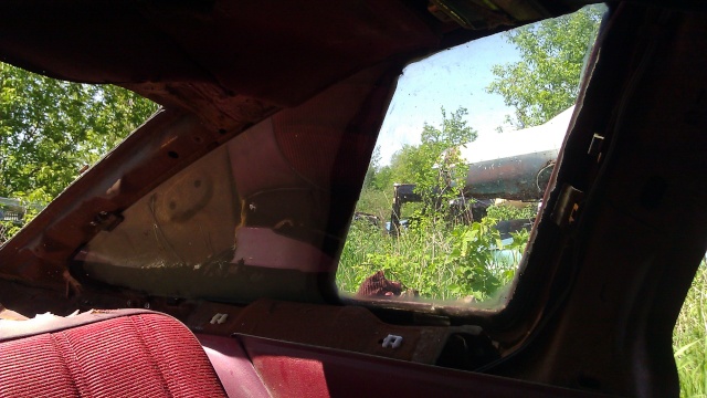

As I understand it, this was RPO option code AB8 where they installed an exterior patch panel over part of the triangular window. Here's a view of one from the inside with the sail panel trim removed:
73 velle with opera windows. 74mali12
Member "73 SS Owner" has one and we're trying to confirm whether or not this glass is the same size as the std colonade window. It seems like they aren't and I can't get out to the yards right now to confirm. Anyone know for sure?

The "patch panel" is the way my '74 Malibu was built. They changed the in later years I believe ...??

From what I remember about the car that Chris posted, the owner himself did that. It started out as full windows like all 73s (should have). Dave is right about the patch panels for (early) 1974. They did the patch panels with early 1974 Malibu Classic, and regular Malibus had the large windows. Until they retooled to make the coach windowed bodies the RIGHT way...
In addition...look at the car Chris posted...coach windows MUCH smaller than factory coach windows.

Interesting...as the first thing I did notice was that the bottom edge molding isn't exactly parallel to the upper qtr panel molding as the larger triangular windows were. Wonder what he used for the window molding, then?
I do find it very coincidental that "73 SS Owner" has found the same situation with his opera windows being smaller than std coach windows. I mean...what are the chances two different owners would custom fabricate smaller than normal coach windows and both would have had moldings to fit? Then, I've got to ask why someone would go to all that trouble in the first place? scratch

Here's a good shot of what they changed over to from the panel that covered the quarter glass.
73 velle with opera windows. P1000211
Steve- the shape of the window you posted looks very similar to what's in my car (77) & had a vinyl top when built (but not a Landau).

I do believe the '74 window w/patch panel is very similar to the std coach windows used up to '77. Just not sure it's exactly the same. You can bet I've got it on my list of things to measure next trip out to the yards. Inquiring minds need to know!

I have to re-tarp my car, I'll measure in the next day or two if you want. For the opera glass trim molding, I'm assuming the outside metal to metal dimensions are what's critical correct? Mine had the full vinyl top when it was built and I have my suspicions that those moldings are slightly different than a regular "hard top" roof car. Don't know for sure but there is still a bit of the vinyl top material under the glass in the openings- it was tucked under on my car, as it was also in the roof rail channels (as a result I think the stainless trim that goes in the roof rail assembly is slightly wider than a hard top also). When I get to my Louvers I'm going to have to remove the glass & sealant in order to remove the left over vinyl to seal/paint & install everything correctly.

Yeah...if you could measure the window frame opening, I'm sure Ken (73 SS Owner) would appreciate knowing whether the new moldings he's got are designed for std coach windows. I've already confirmed they won't fit the '74 triangular windows w/patch panels.
