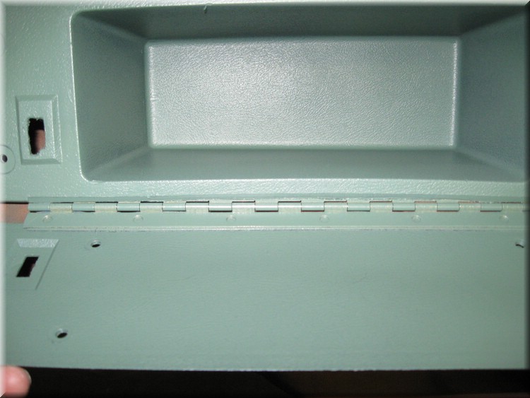

Hi. I do not have one but I have advise. Don't be afraid of one with a broken door hinge. I just repaired mine with a piano hinge from Home depot and that 3M tape that is used for holding on bugshields and those window air deflectors. The repair looks good and I think it will be super strong. I will get to test it next spring.

Here is one. ok that didn't work. I am trying the host it option to attach a pic. I'll keep playing.
I figured it out.
![73-77 Malibu/Monte/El Camino console box My_con14](https://i.servimg.com/u/f63/13/43/15/66/my_con14.jpg)
![73-77 Malibu/Monte/El Camino console box My_con15](https://i.servimg.com/u/f63/13/43/15/66/my_con15.jpg)
![73-77 Malibu/Monte/El Camino console box My_con16](https://i.servimg.com/u/f63/13/43/15/66/my_con16.jpg)
The lid is not screwed to the top in this pic so it does not lay flat. But it looks fine assembled. I just have to put another coat of paint on it first.

so that looks like it turned out pretty well. And the only thing you used to hold the hinge in place is that double sided tape like they use on bug shield deflectors and of the sort?
A_Tame76- G3GM Member
Re: 73-77 Malibu/Monte/El Camino console box
Yep. I'll find out how it holds up this summer. But my bug sheild has been on my Tahoe for 5 years and it has not come loose.
