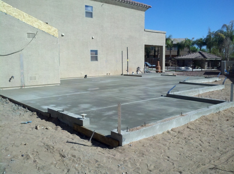

Finished slab:
![New Garage - Lift Installed 2011-020](https://i.servimg.com/u/f29/13/69/09/13/2011-020.jpg)
