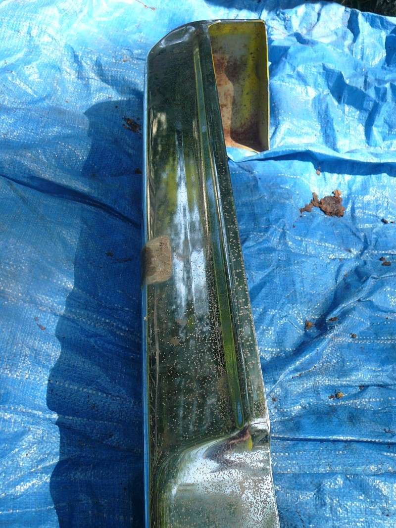

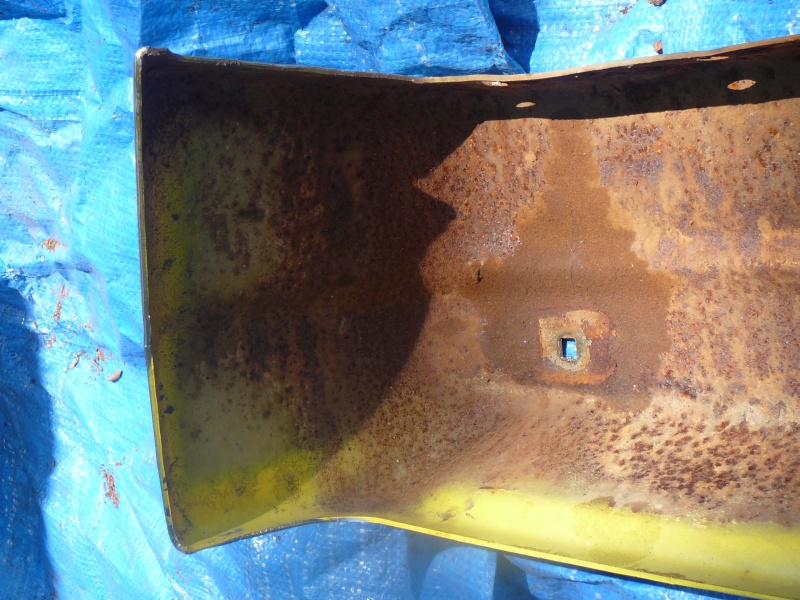

So today has been successful and the rear bumper is apart. I continue to be amazed at how much better steel was back in the era of these A-Body cars. I was expecting that the inner bumper would have swiss cheese holes everywhere, especially since the car had been sitting for at least a year- or two uncovered before I bought it. There is corrosion as you'll see but nothing goes through and I think that when I blast it, I'll be safe w/ a removal of 1.5 to 2 mils, no proble. Any way- I'm posting some pics of the aftermath and like I said, a couple of bolts were a real pain in the a$$ but they were no match for my Dremel tool. There is a close up of the bottom bumper bolt retainer...w/ part of the bolt still attached. The retainer was broken and hence, why it spun freely.

Started the rough sand blast to de-scale. Thanks for the advise I've seen those carriage bolts, very beefy in comparison to the originals- the square shaped part underneath the head is longer and will sit better in the square hole in the outer bumper. Those retainer rings/keepers are a good idea too. Gonna have to replace the ones that are on the brackets that slide into the bumper shocks. Am pondering sinking and cutting the bumpers. Once I get the front off I'll see what I have to work with. I think I'm leaving that to the chrome shop but am getting rid of the bumper strips that stick out & powder coating in whatever the final paint scheme will be.

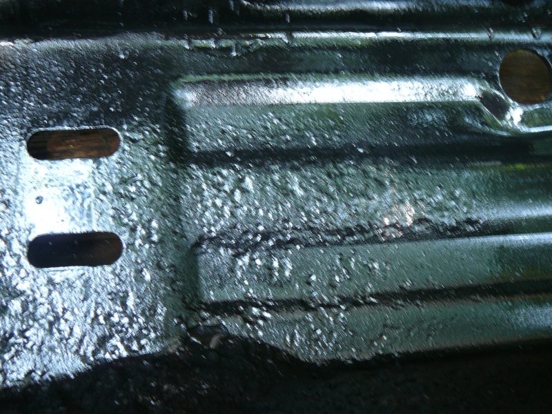

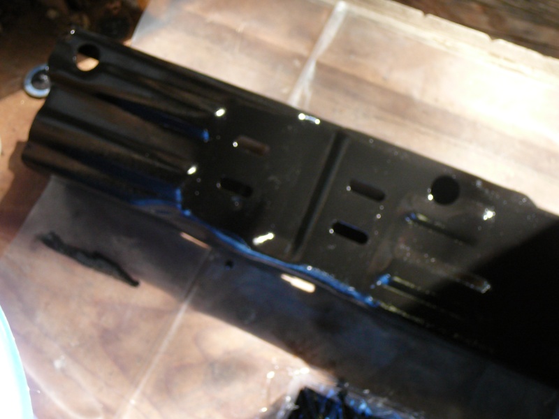

Pics after Por15 on inner bumper. Wish this black color photographed better. Keep in mind that they're close-ups and the majority of the piece is in very good condition (IMHO). 1st few are of worst areas after removal of scale and using their cleaner and metal prep, then the Por15. This stuff levels right into the peaks & valleys of the rough metal. Prop's to Laguna Budman
