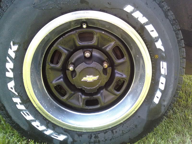

Post by 1973chevelle Fri Apr 20, 2012 1:06 pm
at super Chevy Show there was a whole set of the 73 SS rims with centers beauty rings and good tires. i bought 3 tail lights from the guy. he told me he made a derby car out of a 73 SS
1973chevelle
1973chevelle
