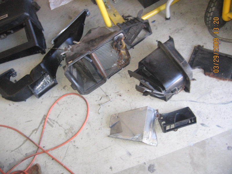

Post by coreys73chevelle Sun Mar 29, 2009 12:12 am
there are two large bolts holding the steering column up. remove them and let the colunm drop down
-remove the large dash frame bolts located on each side of the dash bottom (above kick panels)
-remove the bolts on the top of the dash near the windshield
-there should be 5 smaller bolts i was told but mine was only the two so if your stll on then look for those bolts. Rolling Eyes
dash SHOULD be able to come out BUT be very careful as your wiring and speedo cables do not streach very far so reach back and un hook the speedometer cables and the dash will be free enough to remove the other wires like the headlight harness. and when everything is loose take the dash out. you will have to press down on the steering column it will be tough to do but it will go.
be careful not to break the vents i broke mine and they wont go back in there is not fixing the mounts

Post by JiMi_DRiX Tue Oct 05, 2010 1:02 am
so what did you do behind the dash for insulation? anything? I noticed the ac box/blower motor has some type of a gasket. mine looks like its shrank, and little leaves get in my interior.
taking out my dash Empty Re: taking out my dash
Post by coreys73chevelle Tue Oct 05, 2010 1:06 am
JiMi_DRiX wrote:so what did you do behind the dash for insulation? anything? I noticed the ac box/blower motor has some type of a gasket. mine looks like its shrank, and little leaves get in my interior.
i didnt put anything. just went to bare metal then 2 coats of primer and 3 coats of rustoleum. i was going to put some dynamat though later on. i also added a small brace on the botom of the dash for a little added strenght beause with all the heater stuff out it didnt seem as strong for some reason.
