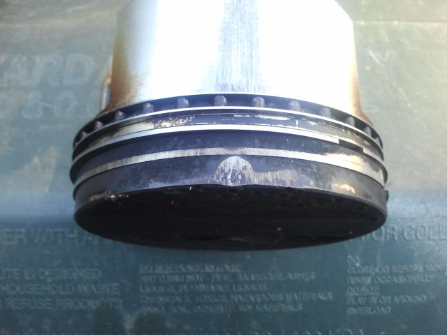

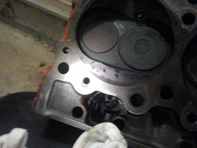

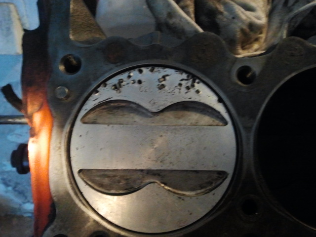

Good evening,
A few days back I picked up Pontiac 400. The seller had the rocker covers and the valley pan cover off for inspection...everything that I could see was super clean. I could tell that at some time in it's life, it received either a rebuild or gasket set as aftermarket gaskets were everywhere. The seller did not have much info on the motor...he got it along with about 38 other engines in some sort of buy-out of a body shop a number of years ago (as a side note, I have NEVER seen so many big block chevy motors in one place, this guy as a TON of 396's) but he did offer my money back if it wasn't rebuild able, So, took it home and pulled the heads and noticed that a portion of the cylinder head on #1 had small little divots in head, not on the valves or the "dome"...but above where the valves sit. The picture will explain it better than I can. There were also about 20 small dents, divots, impact marks.....on the piston itself in the corresponding area. #1 has about 20, #7 has about 12, and #4 has a few as well, with #1 being the worst. They are very small...some have thread impressions and they are not very deep. Obviously something foreign entered this motor, but, I suspect, it happened at startup with just the starter turning the motor or it was shut down immediately when whoever noticed something amiss, as the damage is not nearly as bad as it could have been and the pistons are not completely chewed. The cylinders are perfect...not a scratch anywhere...no gouges nothing. I haven't pulled the pistons out yet to see if the ring lands are compressed...but wondering if this is something anyone else has any experience with? I don't mind buying new pistons..but could these be salvaged or is it end of the road for these guys?
Thanks gang,
Jesse

Ive never seen that before. It kinda looks like some kind of damage from detonation. Maybe pull it out and take it to a machine shop.
Re: Can these pistons be salvaged?
That was my first thought as well, that it was detonation damage. But on one of the pistons you can actually see small indentations of threads...kind of like a grub screw...but I know that a screw wouldn't travel from cylinder to cylinder and if it did, seems to me it would damage the bore as well. These are clean bores...very slight lip, but no damage at all. Weird.

yes a screw or any other object can travel from cylinder to cylinder. It can hang valves open too.....Dont ask how I know

Id sand the top of the pistons down a little and run it, wouldnt hurt anything. I had a valve guide come apart on my 454 with 1000 miles on it, Piston looked worse than yours, ran 12.39 @111mph before it came apart on street tires. Now has about 5000 miles on it and I ran 12.42 @113 mph last month.

I finished tearing it down this evening. All the piston rings looked great with the exception of #4. That piston had the least amount of "screw marks" or whatever it was...however the top ring was completely stuck in the groove near one of the impact sites.
So, to answer my own question, I am not salvaging these slugs...it's going to the machine shop on Tuesday..hopefully it doesn't need any boring...it's already .030 over. I am crossing my fingers for just a hone. The crank and rods were standard sized. The crank hasn't even been turned...bearings were sweet too,but it's already apart and I am gonna just do it right. I will probably spring for new rods too. There really is no deadline on this engine other than my own self-imposed one

Thanks for the feedback guys. I meant to say that I might spring for new rods...i typed that I probably would, I didn't notice that until now. It all depends on what the shop says. Gonna carry the whole mess down tomorrow to the shop, hopefully they can give me some good news. Here is a few more pics.
This is one of they cylinders...can't remember which, I think #4. Pictures of cylinder bores are kinda sketchy...they are smooth, but awfully shiny.
[img]
This is the #7, this is not a flat spot on the side of the piston..it is an illusion of the camera. It is a real clean spot, and this is the point that the ring is trapped. Will not move or expand. The ring wasn't broken but I am sure compression on this cylinder was garbage.
[img]
Again, thanks for all the feedback! I really do appreciate it.
Thanks,
Jesse

The cylinder walls indicate quite a few miles, as well as the scuffing of the piston in the picture. Maybe not unusual for a forged piston (?) Any ridge at the top of the bores ?
There is a bit of a ridge...enough to catch a fingernail on. Some of it is carbon build up, but enough of it is metal to be noticeable.
