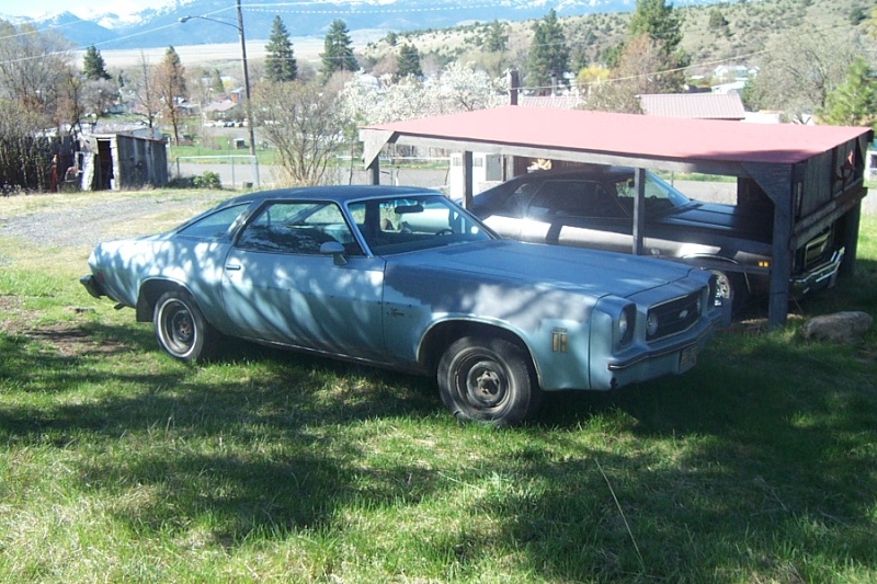

Here's the car as it sat when I got it up into my yard:
Not in terrible condition at all. Came with the 2bbl 350/TH350 combo, dash cap was in good shape, all rust was cosmetic and the vinyl top had long since torn away so it hasn't rusted through the cab. Lucky deal for $300!

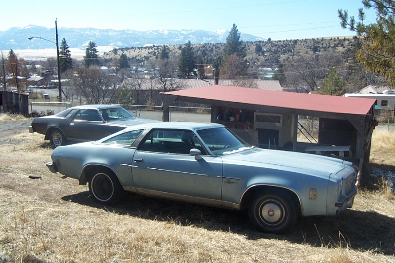

I took the following pic in May:
Just some minor sanding and priming to stop the rusting. I also removed the chrome.
