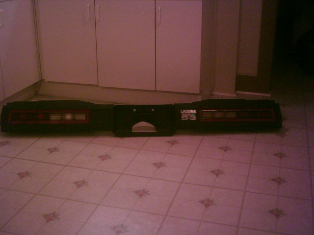

tail panel have done

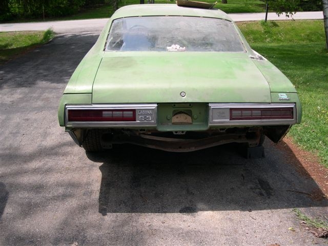

THIS IS BEFORE
just a few touch ups here and there and it will done
AFTER
NOTICE LAGUNA S-3 BACK ON THE CORRECT SIDE WOOT WOOT AND YOU CANT EVEN TELL WHAT WAS UNDER THERE
AFTER

looking good. Finally coming together. How did you scuff up the chrome taillight bezels to make sure the paint will stick good?
A_Tame76- G3GM Member
Re: tail panel have done
i used the 00 steel wool and then went to the 0000 steel wool in procession, and then cleaned it all off real good with a tac cloth (painters will know what this is) and then used clean metal primer let dry for a few coats and then sprayed the flat black. Prob needs one or two more coats of the flat but only bought the one can at the time. so thats all i could do !
