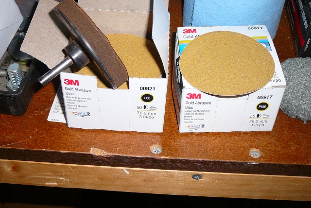

If you want to redo those areas you could use some small 3m sanding discs with a low speed rpm to scuff the blue and blend it into the black paint. They are a "hook-it" type & about 2" in diameter. Chances are it was a contamination issue of some kind that interfered with the bond. I would start with a 400 grit and see what that will look like. I'll post a pic of the discs I use on here if you want. I also use a semi-flexible disc pad.

I'd still like to get rid of most of the black or fade them together better, so if you've got some pictures of the 3M discs that would help.

Search 3M Gold abrasive discs. They're avail 50 per pack in many, many grit types. I got the felxible drill pad from one of the headlight restoration kits (can't remember which). If you have a "Fedrated Auto Parts" franchise near you call them, they may stock them. They're 3" discs & they work pi$$er. They'd work to blend the failed areas into the existing paint so you can re-coat them, Go slow- (low RPM) don't grind the paint just let the paper do the work. I have a low speed lock on my drill and when I use these, I just kinda "hold the weight of the drill" while prepping the surface. It takes a lot of patience not to press down on the surface. Finding the right grit might take some trial & error so if you have something to practice on- I would suggest that first if you haven't done a lot of body work before.
