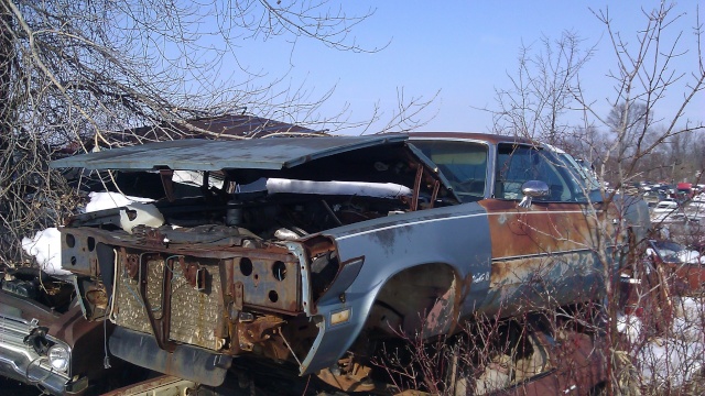

Problem is simple...the hood hinges are shot. You can't imagine how many cars up here in the yards have bent hoods because some moron tried to force them up or worse, down. The pivot bushings are binding. Don't know if there's really any way to adequately lubricate them.

See this all the time from people forcing a hood down. Also see a lot of Chevelle/Malibu hoods with a little dent right in the middle center from people trying to force them open. BE CAREFUL if your hinges are stiff! Best you can do is gently rock the hood back and forth as you open/close it until they can be fixed/replaced.
