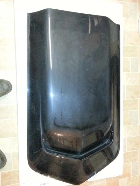

Just found this ad on craigslist. Looks like he has (2) new L88 scoops. In case anyone is looking for one.

The pic of the one that's off the car looks like there is a small crack on it.

Looks like there's not too much room for bolting this bad boy.
