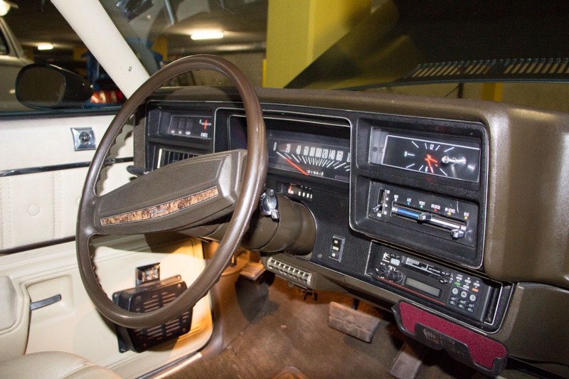

Hi i search for my 74 Chevelle to do my sound system Original:
-A Dash Bezel without a modern radio hole, in Black color.
-A Lower Door Panel in white beige??. Look the picture. I have electrical windows.
Anybody have this parts?
Thank you!

Nice looking interior. I have the same color combo in my SS.

Those look like white door panels, but check your Trim Tag on the cowl for the number. I've seen an Off-White or Beige in '73 models with the dash color like yours, but not sure that was carried over to '74 models. Don't get too hung up on only finding a correct color door panel with the power window switch cutout. Any door panel has a cut-out template on the back that shows where you can cut the opening for the switch. the single switch opening on the passenger side is nothing more than where the round hole is for the manual window crank.
Black dash panel shouldn't be hard to find. I've got original radios.
Is that a rear defrost rocker switch to the right of the strg column? Must have the electric wires-in-the window type of defrost?

I think thats the off-white interior like I have. I've seen that color in 73 and 74. 75 started the pure white interiors.
Interesting on that switch. Never seen one like that before.

the radio is only gonna fit if the dash itself is fixed,not just the bezel. chris had a couple of 73 montes with that color interior.i think GM called it nuetral. the dash was like a brown/green color,he even has those too.

@Mcarlo77 Yes the switch is the rear defrost rocker switch.
I search a dash panel without hole and i think repair is not the same quality like the original.
I found this one: ebay item nr 321052036795
but the rear window defogger switch spare are not available.
