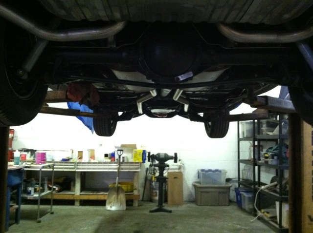

Re: Original Dual exhaust System?
Just make sure you have a double hump crossmember. My '74 came with one, but it would bee a good idea to make sure.
Very true. You can also notch the one you have if need be.
77mali wrote:Very true. You can also notch the one you have if need be.
I notched mine and worked great !!!

73 and 74 ( MOST ) Are dual exhaust crossmembers 75 and up went to Cats on MOST cars and went to single exhaust on MOST this is what the dual exhaust looked like
