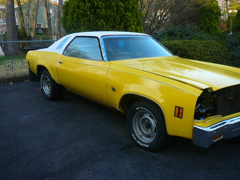

heres how the monte looked when i bough it
Re: Chevelle stance
Kinda sat cool in that pic. Maybe if the back was a 1/2 inch lower.
Re: Chevelle stance
Always liked the old school stink bug look
Re: Chevelle stance
That is my ideal stance, low in the front with a little rake.ant7377 wrote:Kinda sat cool in that pic. Maybe if the back was a 1/2 inch lower.
