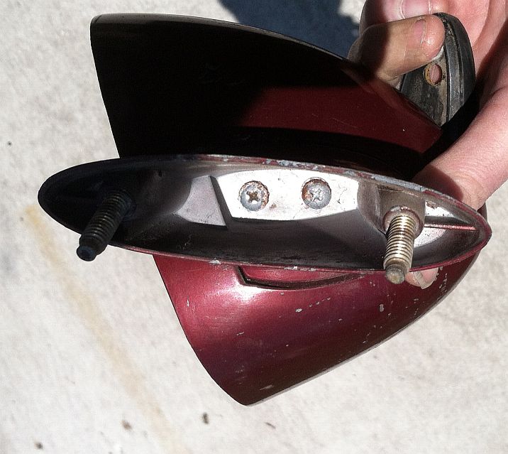

Does anyone have a cure for loose heads on our sport mirrors. They rattle and I am just not sure IF you can fix them, or do you have to replace them?

You can take them apart after you Pull from Door, and Put either a bigger bolt with washer Like I had to with mine, or Just maybe get lucky and tighten up with adding a washer to existing bolts, Def have to pull from from door to do

Just to be clear, I am talking about the head(cup) being loose from the pedastel that it mounts on. Not the mirror unit being loose on the door. Is there a bolt that holds them together behind the glass, or are they press- fit or something?

these 2 bolts hold it to the door
these 2 screws hold the base,shell and mirror together.
Re: loose sport mirrors
Looks like you could just tighten the screws after removing it from the door.

Yes, those two screws are what I wanted to know about. I may use some locktite on them before reassembly to make sure they dont get loose again. Thanks guys!
