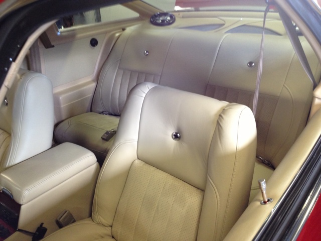

Here is before seat where done
[url=[url=https://servimg.com/view/17248508/205]custom parts building Img_5510
After seats still not happy with the way they came out but they are ok for now.
[url=[url=https://servimg.com/view/17248508/207]custom parts building Seats_10
