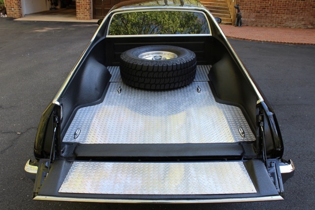

[img]Any comments? - Page 2 Downsi13[/img]
Not permanently installed yet, adjustments will be made to height also. I removed bed panel to clean up and reseal, after mock up is finished. I'm thinking about getting some aluminum diamond plate and cut to shape of bed panel, so as not to destroy original one.[img]Any comments? - Page 2 T2ec1610[/img]
Got idea for diamond plate from this pic I found on youtube.

Post by dynchel Wed May 08, 2013 12:50 am
I've seen regular p/u trucks with the diamond plate bed floor. It looks good and is way less prone to damage than the original sheet metal. I think it would work good with the "mad max" theme you're going for.
