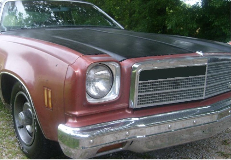

In the pic above you can two spots in my grill that are discolored. I have no idea what they are from and I am not sure if they will come off. I plan to wash the car this week and see if it will come off. If not, I am thinking of painting the grill or at least the areas like the one below.

Kinda strange that just a few places would be discolored. It's a 1-piece cast grille. Maybe you can try some solvent on it, of some Mothers metal polish, before you resort to painting it.
Just some ideas.....

licolor argent silver Wheel Paint would look gioid on there. JB

I sandblasted and painted a spare '74 grille for for my car. I always preferred the '77 Malibu classic grille, so I painted the entire center semigloss black, and the top and sides aluminum silver.

The color is 1971 (or '72 I can't remember) mulistane blue with 1998 fleet white stripes. I will mention that if you decide to paint the grille this way make sure the surface is well scuffed, and use a durable paint. I used duplicolor ceramic engine paint , and chips are minimal.
