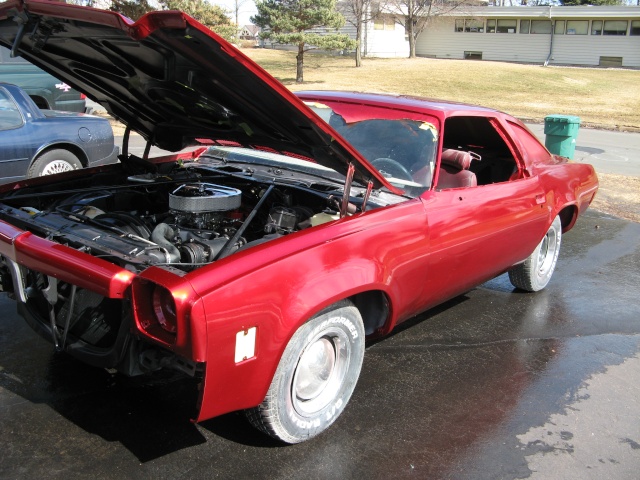

So I always prided myself on being a fairly intelligent person. I try to do things correctly and I have yet to find a task in life I couldn't do. From automotive to projects around the house, to things at work; I have always tried and accomplished random tasks that many would not attempt.
My last car , a 1967 Cutlass Supreme conv. got a complete frame off resto. where I performed all work except the paint. I did everything from the welding of the body to the full interior work to the new convertible top. I hired my brothers friend to paint the car and it was the worst part of the car. I drove that car for about 5 years but got bored with it so I sold it and started my latest car.
This 1974 Malibu Classic needed alot of work but I thought I could do it. It has the swivels seats, full gauges, power locks and windows. I built a ZZ430 engine for it and reworked a 200r-4 trans. I also redid a late model posi with disc brakes but it is not in the car yet. So when it came time to do body work and paint, I decided to do it myself.
This is were I am having troubles. I wish I know not to use metallc Single Stage paint for my first attempt. It has been very difficult to get the peces prepped and cleaned, then lay a good coat without runs or drips, and try to keep it clean with no crap in the paint as it dries. To this point I have lacked in at least one pf these categories for almost every attempt. I have some pieces done but the hood and one of the fenders has been a bear. I either have crap in the paint or the metallic gets clumpy and I have to do it again.
Please don't think I am giving up. I will paint this car and I will have it looking right. If I have to sand it all off and paint it 100 times. Just a lesson for everyone reading this: UNLESS YOU ARE AN ACCOMPLISHED PAINTER AND HAVE ACCESS TO A PROPER PAINT BOTH; STICK TO BASE/CLEAR PAINT OR SINGLE STAGE COLORS WITHOUT METALLIC!!![Head Bang](/users/1813/58/83/10/smiles/772947.gif)

![Just thought I would share.... <a href=](<a href=)
![Just thought I would share.... Img_2714](https://i.servimg.com/u/f39/17/24/85/08/img_2714.jpg)
I had jammed the doors and the door frame before I started the candy paint job. I have done them both ways. It is hard to get the paint on nice in the hinge area but it can be done.
Here It is sanding clear for dust bugs and what ever else you get I did not have any runs (this time) and then buffed out.
After sanding a buffing.

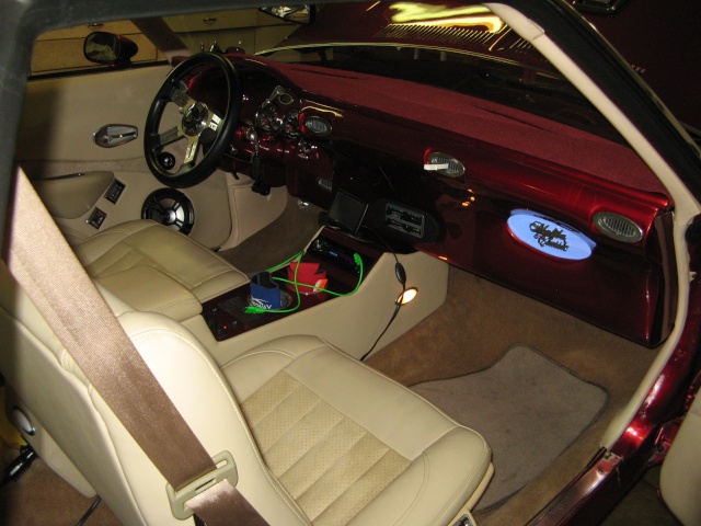

I love that color! What color did you do the interior?
bitterfitter- Donating Member
Re: Just thought I would share....
Light buck skin tan leather

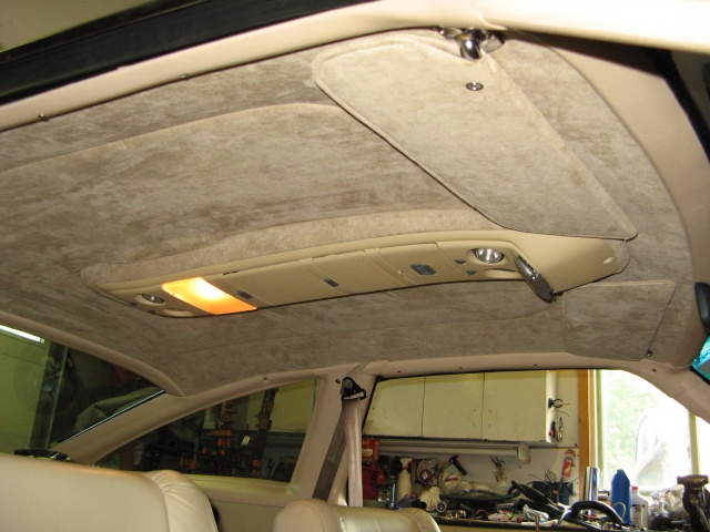

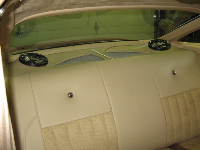

![Just thought I would share.... Img_7114](https://i.servimg.com/u/f39/17/24/85/08/img_7114.jpg)
![Just thought I would share.... Img_7115](https://i.servimg.com/u/f39/17/24/85/08/img_7115.jpg)
![Just thought I would share.... Img_7116](https://i.servimg.com/u/f39/17/24/85/08/img_7116.jpg)
![Just thought I would share.... Img_7117](https://i.servimg.com/u/f39/17/24/85/08/img_7117.jpg)
![Just thought I would share.... Img_7118](https://i.servimg.com/u/f39/17/24/85/08/img_7118.jpg)
