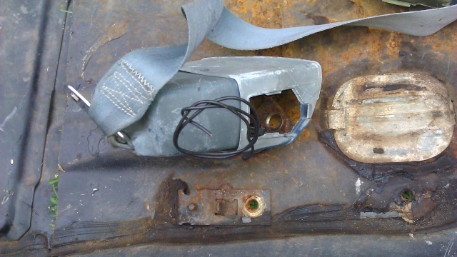

hello and thank you in advance for any help. I have a 73 malibu it had a bench i took it out and i am trying to put a 73 laguna bucket in it place but the hole doint line up wich i see in othere post and was told to use the first hole in on the driver side? It sits on the bump and looks to be really close to the door?and back hole will cover the seat belt hole so do i just plug that up and make a new location for the seat belt? would really help to see a picture or any photos form some of the people that have gone this route. really making me mad that i cant figure this out...

FYI swivel buckets use different seat belt retractors than bench seats, they don't mount to the top like the bench.

Here...these pics should make it a little clearer as to how the swivel buckets mount. You utilize your existing front outer mounting holes. You'll need to add the front and rear inners as shown. Hard to see...but, there is a threaded stud welded to the rearward-most floor bracket support for the rear inner mounting point. The rear outers are also added with the bracket shown. And, finally...note the unique retractor used for swivel buckets. If you look closely where the plastic trim flap is missing, you'll see a bracket with a mtg hole. That goes over the rearward mtg hole on the floor bracket and held in place with a torx bolt. The seat does sit very close to the door. Hope this helps.
Also, disregard what's going on with the passenger side mtg points...primarily that raised black bracket in the rear. The original mtg stud is still there under that bracket. Previous owner was doing something unusual there.

thanks for the photos that helps a lot because the seat does sit close to the door and i have a 73 laguna that i am taking some parts from to build my car.
