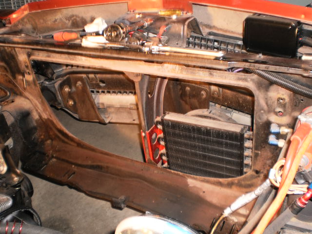

I have a monster Derale with a 10" pusher fan in front (visible in the photo below from when I was swapping the A/C condenser), mounted to the radiator brace and the header support. It's plumbed after the stock cooler, and the fan is temp controlled and only kicks on after a significant amount of driving. I wasn't taking any chances after spending 2k on the OD trans. ![Smile](https://2img.net/i/fa/i/smiles/icon_smile.gif)
