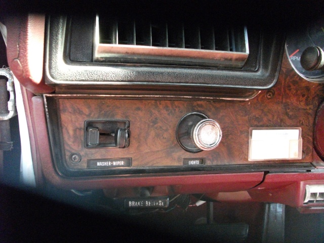

Intermittent wipers are pretty rare for our cars. Rotary dial switch version even more so. Usually, it's a slide bar. Slide bar style would fit just fine into your '77 dash bezel. Assume the rotary style would too...as I doubt GM provided a special bezel just for those. If he gave you the necessary wiring pigtail that runs out to the wiper motor, it's a fairly easy swap.
Really weird part question 1976la12

I have one of those that steve has in the above picture. It goes in the same spot. Im missing one of the knobs on it though. I might put it in one day
