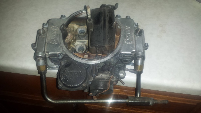

The combo kit he posted comes with a fuel line, will need sonething that hooks the fuel pump to the new line though

I use the original cable on my 77 with a holley and it goes WOT originally had a 305 2bbl. I use holleys throttle bracket its kind of a plate with a bracket that bolts to it that I modified for use with the Vortec manifold.
Re: Summit Carb/Intake Manifold Pro Packs
looks like this but was in a holley box. Bought it years ago http://www.professional-products.com/Cable-Bracket-Kit-Steel-p229.html

ant7377 wrote:looks like this but was in a holley box. Bought it years ago http://www.professional-products.com/Cable-Bracket-Kit-Steel-p229.html
I have the same style but my manifold is a Vortec bolt pattern. That's a good price mine is an Edelbrock $34.00 (paying for the name LOL)
As far as the fuel line, I was able to reuse the original steel line from the fuel pump. Used 3/8" rubber fuel line & a filter between that & the carb and it lined up really well. Sometimes however the fitting for the fuel line inlet might be for 5/16" line. Make sure it's for 3/8".

Paul, maybe it was an Edlebrock box. The first George Bush was still president and I had a full head of hair when I bought it at Performance Center of America. Remember that?
