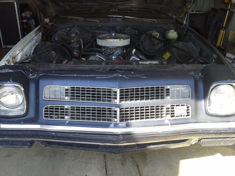

Post by Memphis Laguna Sun Mar 08, 2015 12:43 am
What can I use to fill in gashes in the 1975 Laguna nose nothing serious just a few surface issues...someone has posted the question before but I cant find it.

Duraglass, (or any kind of fiberglass reinforced) filler would be my guess.
75 laguna nose repair Empty Re: 75 laguna nose repair
Post by Joe73 Sun Mar 08, 2015 10:17 am
Isnt the nose made of urethane? I'd be looking at the company SEM for their repair products. Should be something similar to a bumper repair kit since it needs to flex a bit.

dynchel wrote:Duraglass, (or any kind of fiberglass reinforced) filler would be my guess.
I don't believe Duraglass is the right way to go on this. The front nose is semi flexible.
I would use this as it needs to have flex ability in it.

Just watched this video on the product
and they used this after the major repair
40482 http://www.semproducts.com/automotive-fillers-glazes/bumper-bite
You may be able to just use the 40482

This is what I used on mine and worked great
75 laguna nose repair Lagunaprep

Limey SE wrote:This is what I used on mine and worked great
or one particular
Did you you use all the products mentioned or one in particular?

All for the repair

A 3M product called "Problem Plastic". Available at Walmart.com of all places.

It's a SEM product and I believe product #39767 is correct.I haven't started on mine yet but another laguna owner was really happy with his results.I found it by doing an internet search and IIRC it was a guy on chevytalk.org who was bragging on it.It ain't cheap but I thought I would just share my discovery with the other "slantnose" owners here.
