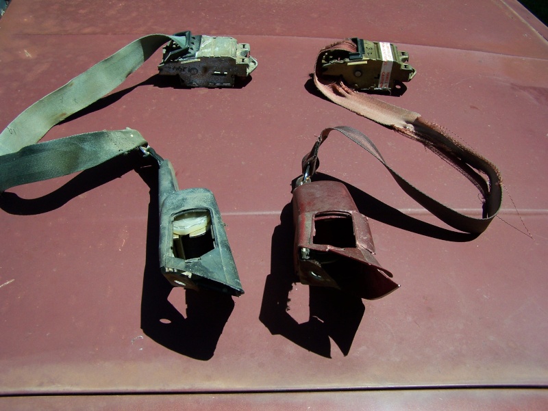

So here's how the saga seems to have ended.
I have a 75 Laguna which I refer to as the organ donor. So you can guess its role in life. The PM I got suggested that maybe the power bench retractors and the swivel bucket retractors might be similar. It just so happens the organ donor had a power bench and I saved the retractors. The first pic is of the power bench retractor on the left and the swivel bucket retractor on the right. Both are for driver's side.

So the proof came down to when I tried mounting the power bench retractor next to the swivel bucket seat. Now my 74 Laguna does have factory swivel buckets so all the holes and threads are in place. Voila! Works just fine. I've now got a drivers belt, both shoulder and lap that should pass a Texas inspection.
For the folks looking to retrofit the swivel buckets, power bench retractors give you another option. Gotta be a few cars out there with power benches that can repurpose their seat belt retractors.
The really good part to all this is that I had the retractors from the organ donor, so the fix only cost me a little time and the usual skinned knuckles.
