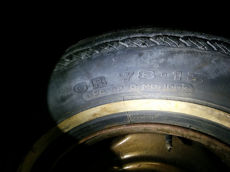

My spare tire is an original GR78. A true time capsule!
![Tire size to replace 215/75R15 ? Img_2010](https://i.servimg.com/u/f18/19/25/86/75/img_2010.jpg)
