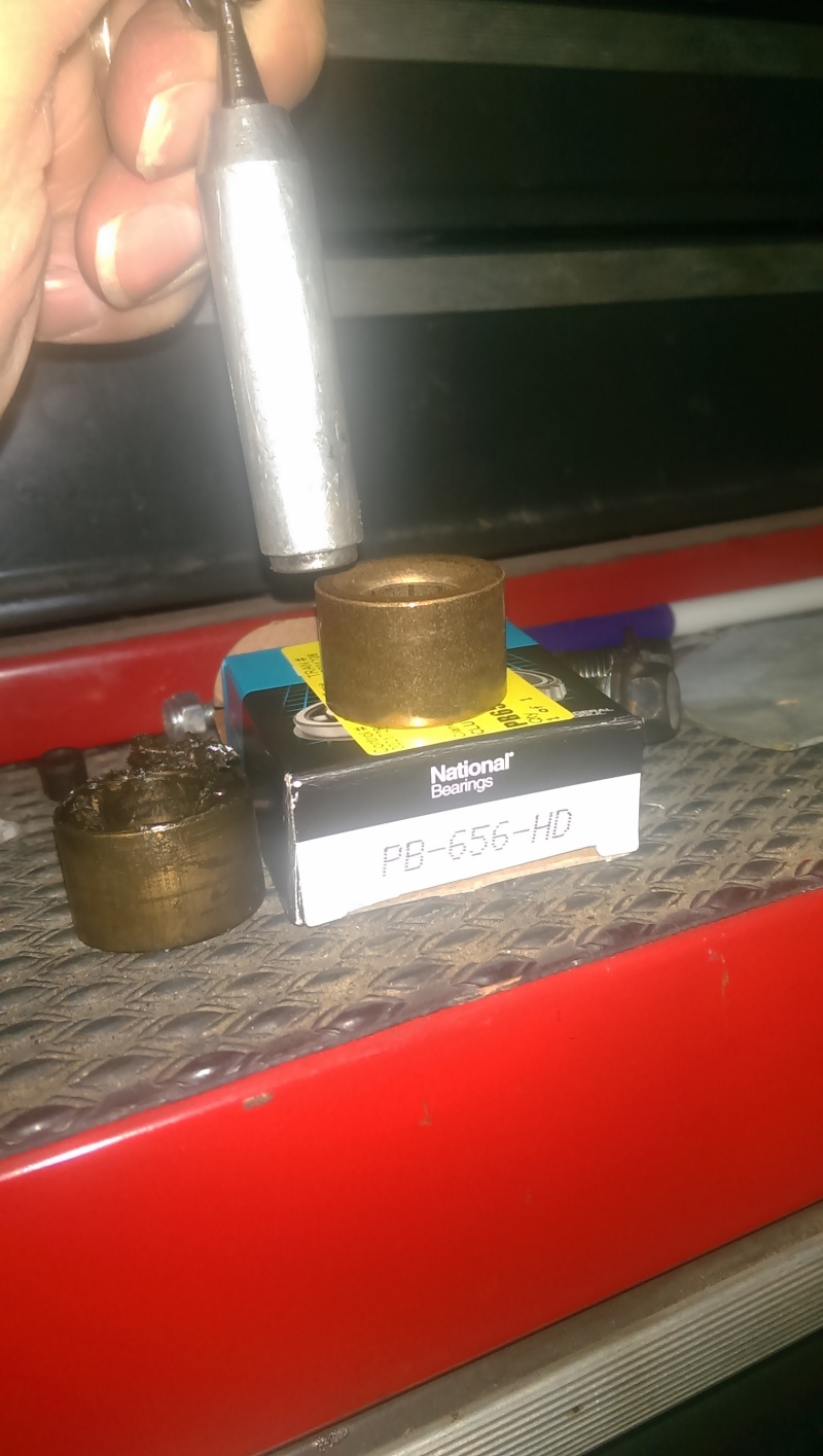

Sorry Joe, I just realized you gave me the pilot bushing NAPA number, what I just posted was the kit number. i'll call NAPA and see if they can get your number. Also, for comparison, attached is a photo. Old bushing on left, new correct size NAPA bushing in middle but is magnetic, then incorrect size bushing also from the NAPA kit on the right, which is non-magnetic.
clanceman427- G3GM Enthusiast
Re: where to get good pilot bushing?
I wonder what the one on the right is for. Its pretty big, kind of looks like a washer or something. Usually when you look at a pilot bushing and it kind of has a "lead" color to it, its usually magnetic.

Well NAPA no longer has that part number my store says for 10 years. They carry a Dorman part number now that is magnetic. I went to Advance next and asked for the HD part number you gave. It's at another store and I had the other store verify non magnetic and they said it's not, so I'll pick that up later today, yay!. Thanks Joe!

Success! Go to Advance Auto for these! Thanks again Joe!
