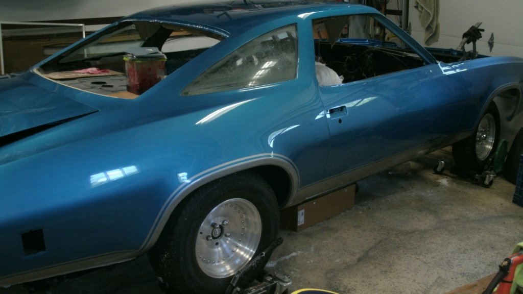

Re: 1973 Chevelle SS, 350, 4spd. build
Painted her in October 2016. Finally felt like doing some sanding and buffing. Big difference in the color of the paint due to the lighting. The shots of the quarter is under LED garage lights. The front fender is with the lights off, just outside natural light. Cant wait to see it in daylight someday.
This is a side shot of how it sat for over a year and a half. Untouched, unsanded.

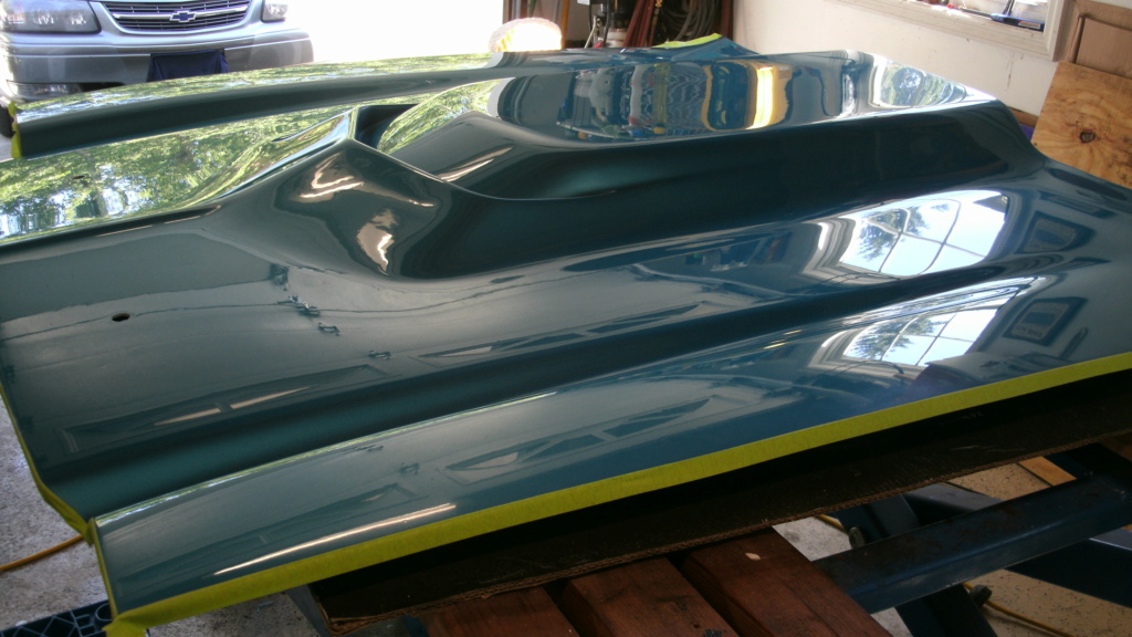

L88 glass Hood is buffed. Have to take care of a couple specs then buff again. Then polish. First pic is the day I sprayed it in 2016.

Final buffed, glazed and waxed the hood and roof of the car. Needed to get the hood out of the way so I figured I'd make it wall art.

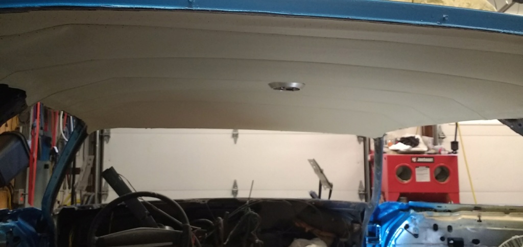

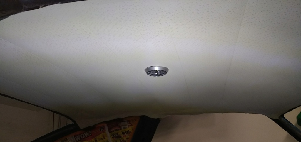

Headliner is installed. Actually went pretty quick and smooth. I usually us 3M 77 or 90 but decided to use Permatex headliner adhesive instead. Worked very well. Headliner is from Acme headliners in California. Their products are top notch. I have all my upholstery from them as well. Paid $80 for the headliner delivered from RockAuto.com.

Looks great Joe! Do you have a pic of the hardware used to hang it? Just curious if its the same as the one I ordered from OPGI.
- Street Cred : 34
No pic of the hardware. Its different than original stuff. It comes with a 5 steel rods about 45 in. long each. Each slide into a sleeve on the headliner. Then you have white plastic clips that slide over the rod. Little difficult to explain but real easy to do. I saved my original "T" strips from the back of my old headliner, just for a spare in case. I thought of just having someone stick it onto the sleeves on the new one. But it worked out great as is.
- Street Cred : 83
That sounds exactly like the kit I purchased from OPGI. I'm not really crazy about the metal rods as they tend to rust over the years. Especially in this Houston humidity. I did spray mine with a clear from a rattle can before I installed them in hopes that would slow it down. Time will tell. I kept my original headliner with the original mounts as well just in case I want to reuse them down the road. Thanks for the info!
- Street Cred : 34
Cool. My original mounts are the same as yours. Black plastic with the T built in. I have 2 sets of them now. LOL.
