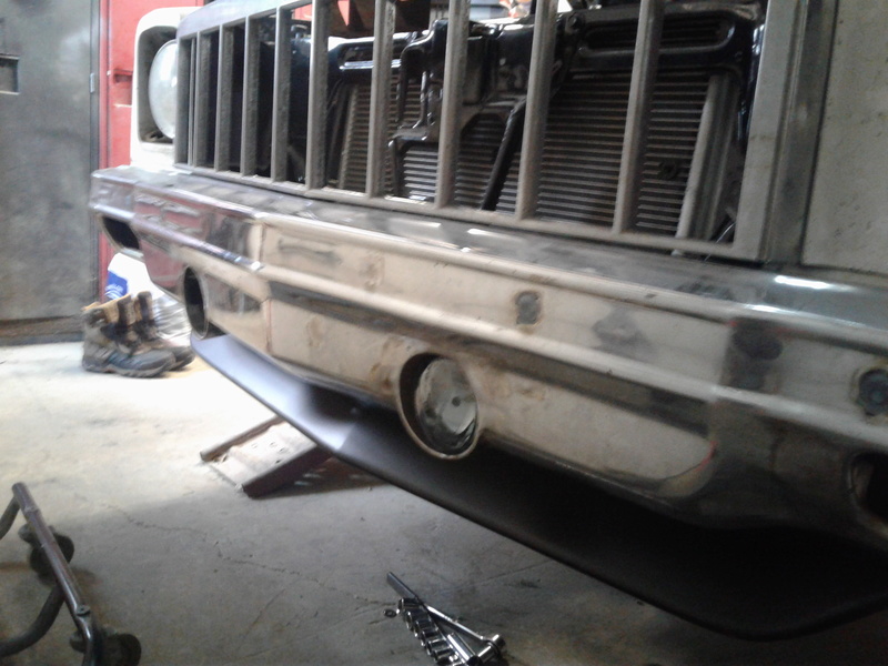

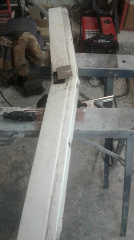

Front bumper done. Recess with my bracket. 2" was cut on the lenght of the bumper. I install Dodge Neon 4" fogs light and BMW parking light. Install the spoiler under the bumper.

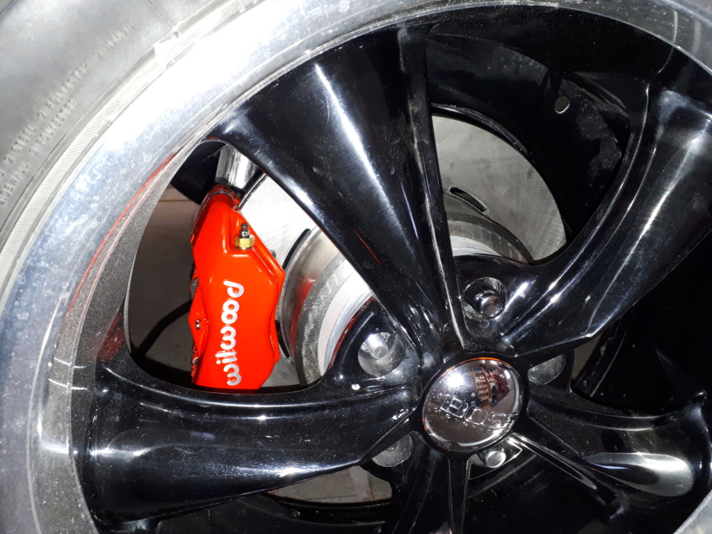

Finish the rear Wilwood brakes installation, i had to oversize the inside hole of the adaptor on a lathe to fit my diff,

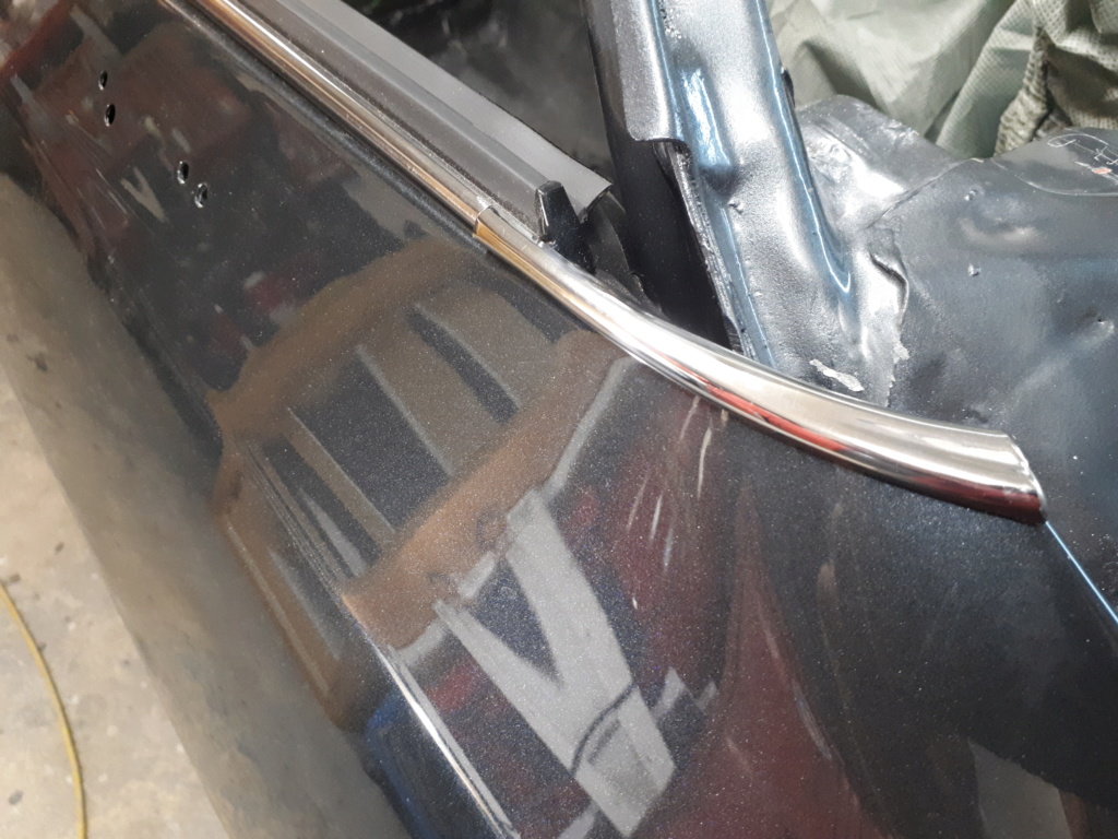

Doors handles and seals done.

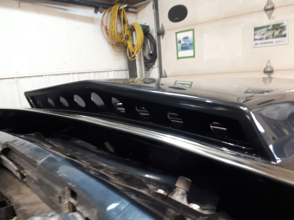

I cut it out and used the original nails. Made a scoop grill.

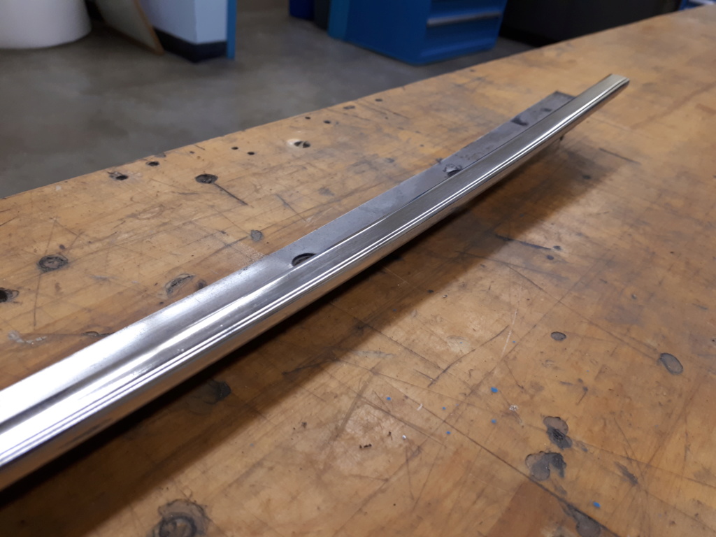

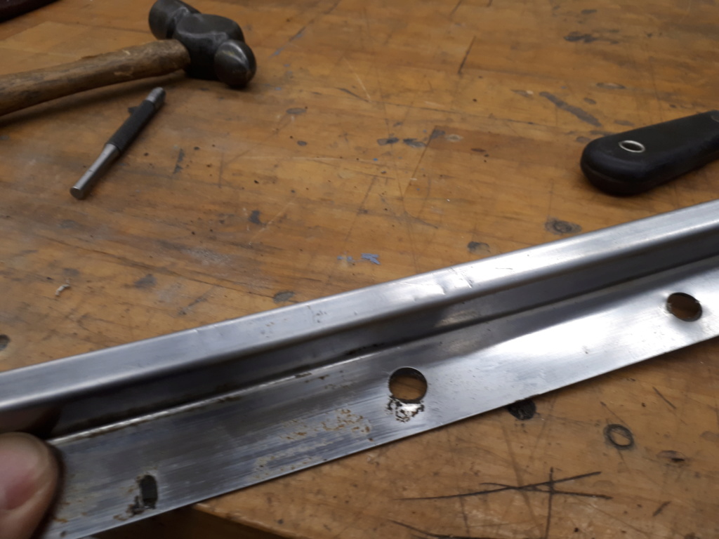

Fix and polish trims.
Cowl hood seal was junk to. Too fat and too rigid. The holes are not made and the nails included too big.
