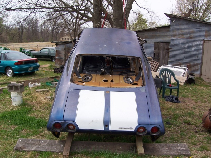

Today we got back to this car. We pulled the gas tank and rear bumper. OMG the rear bumper weighs like 600 pounds. We ended up grinding off one of the heads on the bumper brackets.
Also pulled out all the body to frame bolts. All came out pretty easy except for the 4 front ones. They were tough and then one of them was completely rusted through. Were probably gonna have to drill it out. Body will be off tomorrow.
The frame looks like it needs alot of work. The farthest rear mounts are rusted and someone has wrapped a chain around it and bent the rear frame crossmember. We got our work cut out on this one.

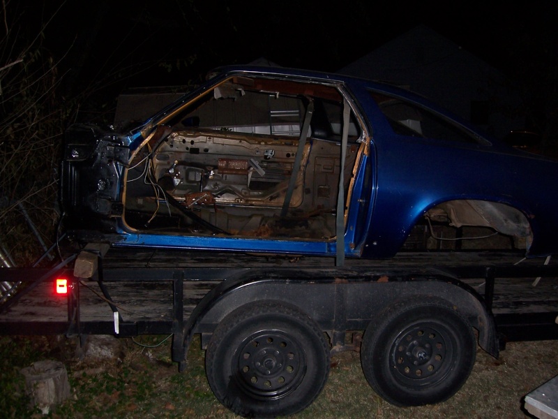

Heres some of the progress today. IT GOT A NEW FRAME LOL

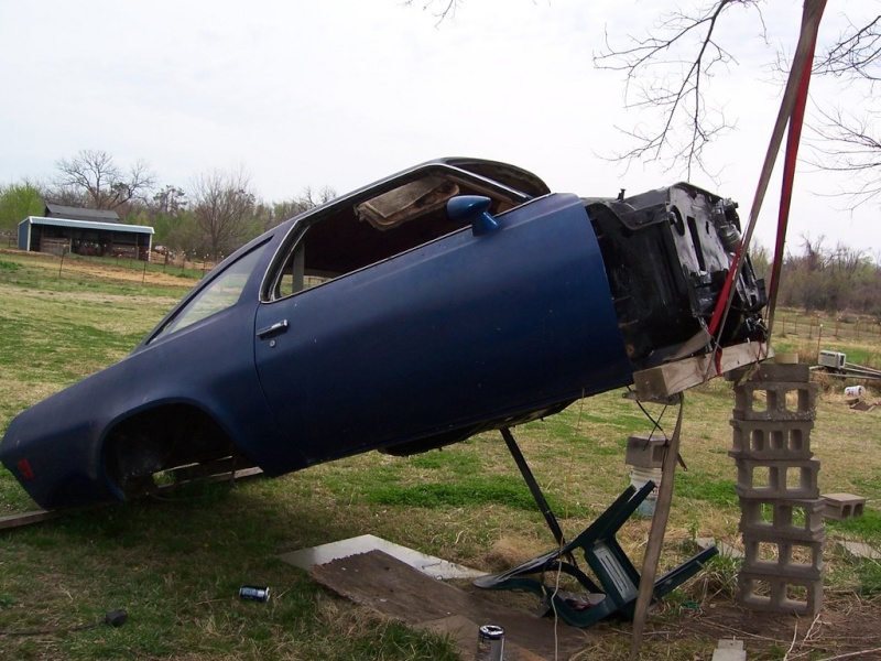

tree hanging
BlackChevelleSS- Management
Re: My Cousins 73 SS 454
well thats one way to get teh frame off from under the car LOL
just please dont tell me your under it when its like this LOL
Yep its not bad, if those straps shouldnt break, but I dunno about the tree. the bricks were there just to stabilize it and keep it from swinging.
