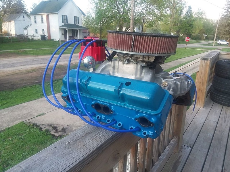

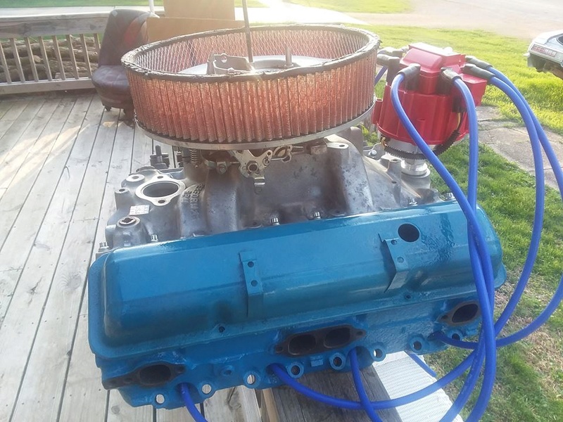

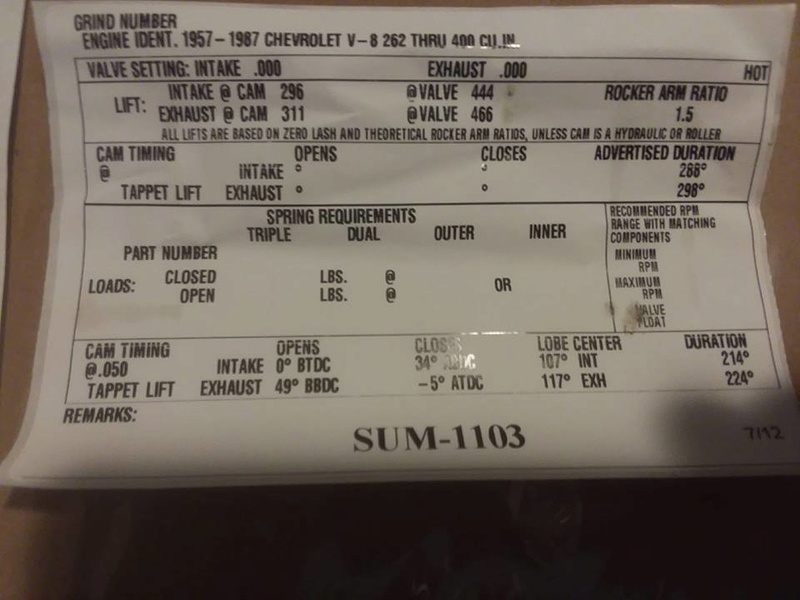

Well Now Winter is Almost over I HOPE anyways..... Have The Cam Kit thanks to some great Advice from Joe73 yet again ( you need to open a speed Shop Joe) LOL
Can not wait to get Busy on this SE yet again

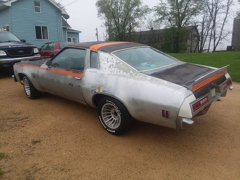

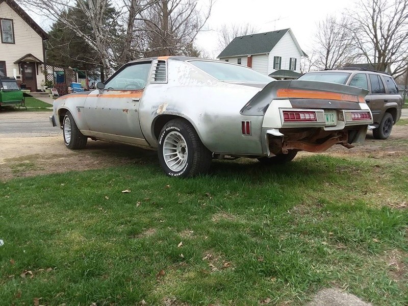

Post by Limey SE Tue May 01, 2018 7:00 pm
Well Finally got to be able to get the tails on that I got from Mcarlo77 aka Steve They look so soooooo much better and clearer

Post by Mcarlo77 Tue May 01, 2018 7:26 pm
They look great! Glad I saved them from the crusher for 'ya.

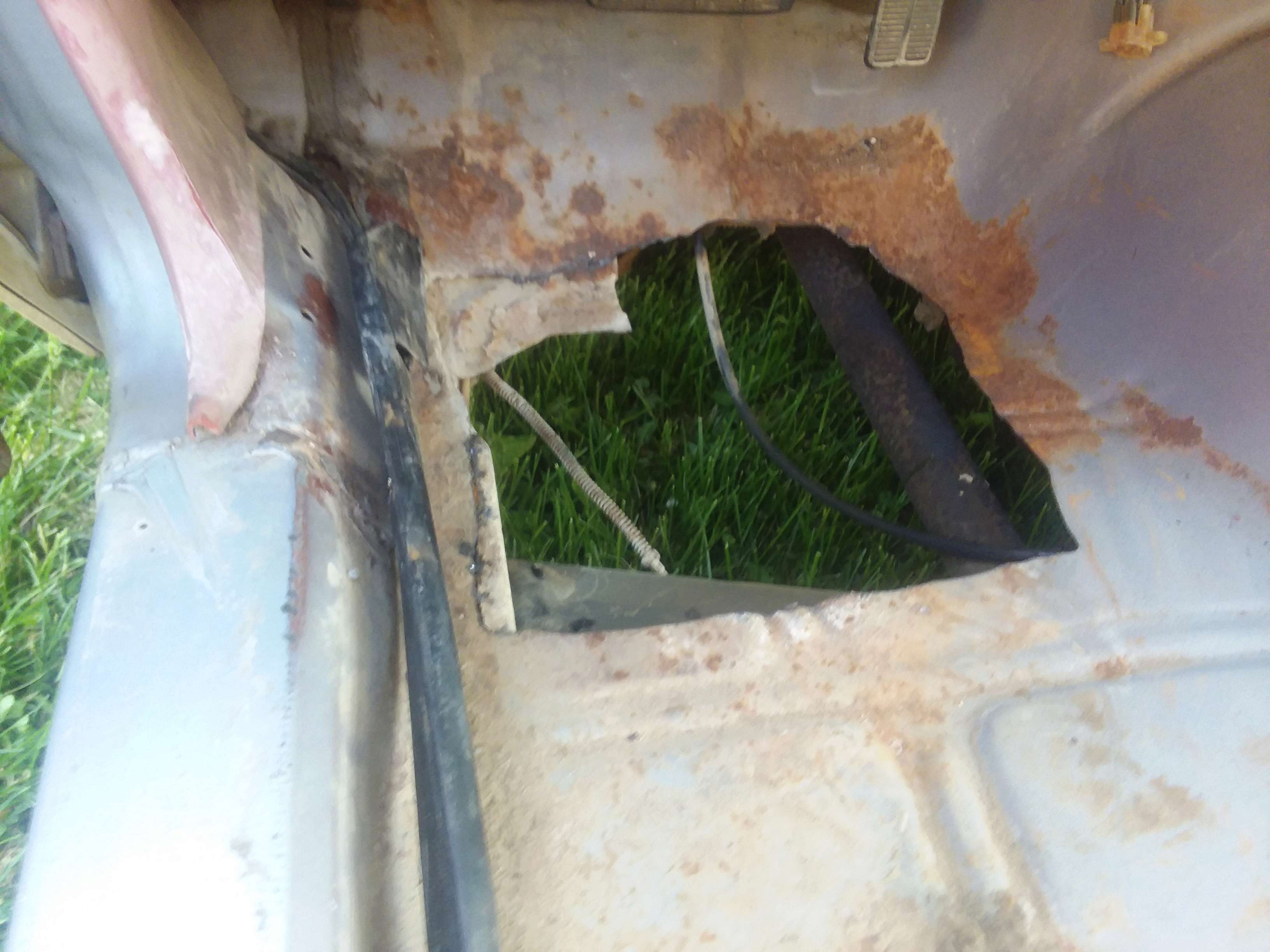

Post by Limey SE Tue May 29, 2018 10:16 pm
Well long story short welder bailed on me decided he didn't want to do floors anymore AFTER he cut floors out wtf.....
Anyways fast fwd alot of talking to some friends and body guys since I CAN NOT WELD  I used 3m Panel bond I think it turned out good for first time floor work

Post by Mcarlo77 Tue May 29, 2018 11:32 pm
I think it looks good, Limey! I'm kind of in the same boat with no welding skills and a passenger side patch needed on the Laguna. Have contemplated doing this myself...but, been hesitant due to all the negativity I keep reading about from the welding purists. Did you enlarge what was already cut out and overlap an inch or so all around? Or, just lay down the full size replacement panels over what was already cut out? What about the underside...did, or are you going to use seam sealer at the overlap edges to seal them? What is the purpose of the spots of epoxy around the perimeters?
This SE Now Belongs to my 18 year old daughter now LOL  - Page 6 Empty Re: This SE Now Belongs to my 18 year old daughter now LOL
Post by thatfnthing Wed May 30, 2018 9:23 am
I agree -- nice job! While welding might be optimal, it's not always an option. There are other satisfactory ways of addressing rust in a hidden, non-structural area like the cabin floor. Unless you're planning to enter it at Pebble Beach Concours d'Elegance, panel bonding is perfectly fine.
