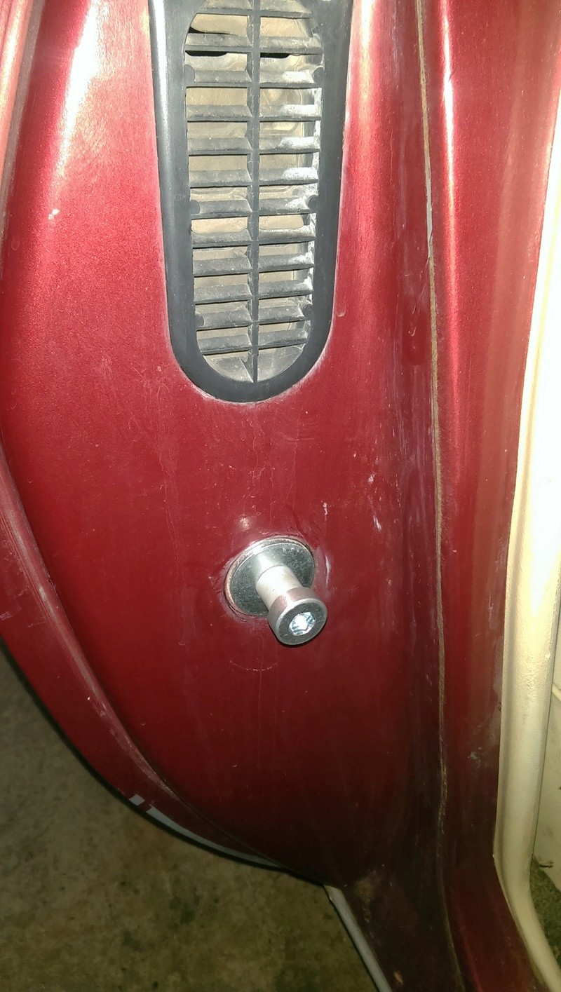

Post by clanceman427 Sat Sep 24, 2016 10:46 am
Well my NAPA didn't have the Dorman striker bushing but cross referenced to their number which was the whole bolt.  Incorrect shape and drive recess for 1973 so I will return this and order Dorman online parts.  It was nice to feel that solid secure clunk of shutting the door!  But I still get door droop on passenger side so I will service both hinges and strikers this winter.
Door latching-is my car needing adjustment? Imag1612
Street Cred : 16
Door latching-is my car needing adjustment? Empty Re: Door latching-is my car needing adjustment?
Post by Joe73 Sat Sep 24, 2016 10:57 am
Is that a pic of the Dorman? I put Dorman strickers in my car last week and they look just like those.
Post by clanceman427 Sat Sep 24, 2016 11:23 am
No it was a NAPA part.
The NAPA part will work but it contains a hex recess instead of the factory torx recess. Also, factory striker has 2 flats on the o.d. where the recess is.
