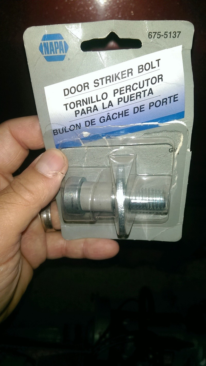

This is the NAPA I bought

If you wanted to you could make your own striker bushings and put them on your original strikers. Looks like they are just plastic 0.7" o.d., 0.545" I.d. and 0.725" long

I bought mine at O'Reilly's. I believe the package said GM truck. I did not use the striker, just put the new bushing on the original striker. Dont know if the new one would fit or not. I was planning on using the original striker when I bought it.

yeah, this napa part cost me 30 dollars, so there's no way I'm gonna pay 60 dollars to only use the plastic sleeves. I'll return this and make my own, since the metal components aren't 100% correct

I know for fact that I did not pay anywhere close to $30. I'm sure it was $6 or $7 dollars. I agree I would not pay $60 for 2 pieces of plastic.

Just went and looked at the new striker that I did not use. It has the hex head, not the torx head. So yes it is not correct for our cars, but like I said earlier, I only wanted the plastic part.

clanceman427 wrote:yeah, this napa part cost me 30 dollars, so there's no way I'm gonna pay 60 dollars to only use the plastic sleeves. Â I'll return this and make my own, since the metal components aren't 100% correct
To be fair the NAPA part actually costs $15, not $30. I forgot that I paid for 2 when I was there.

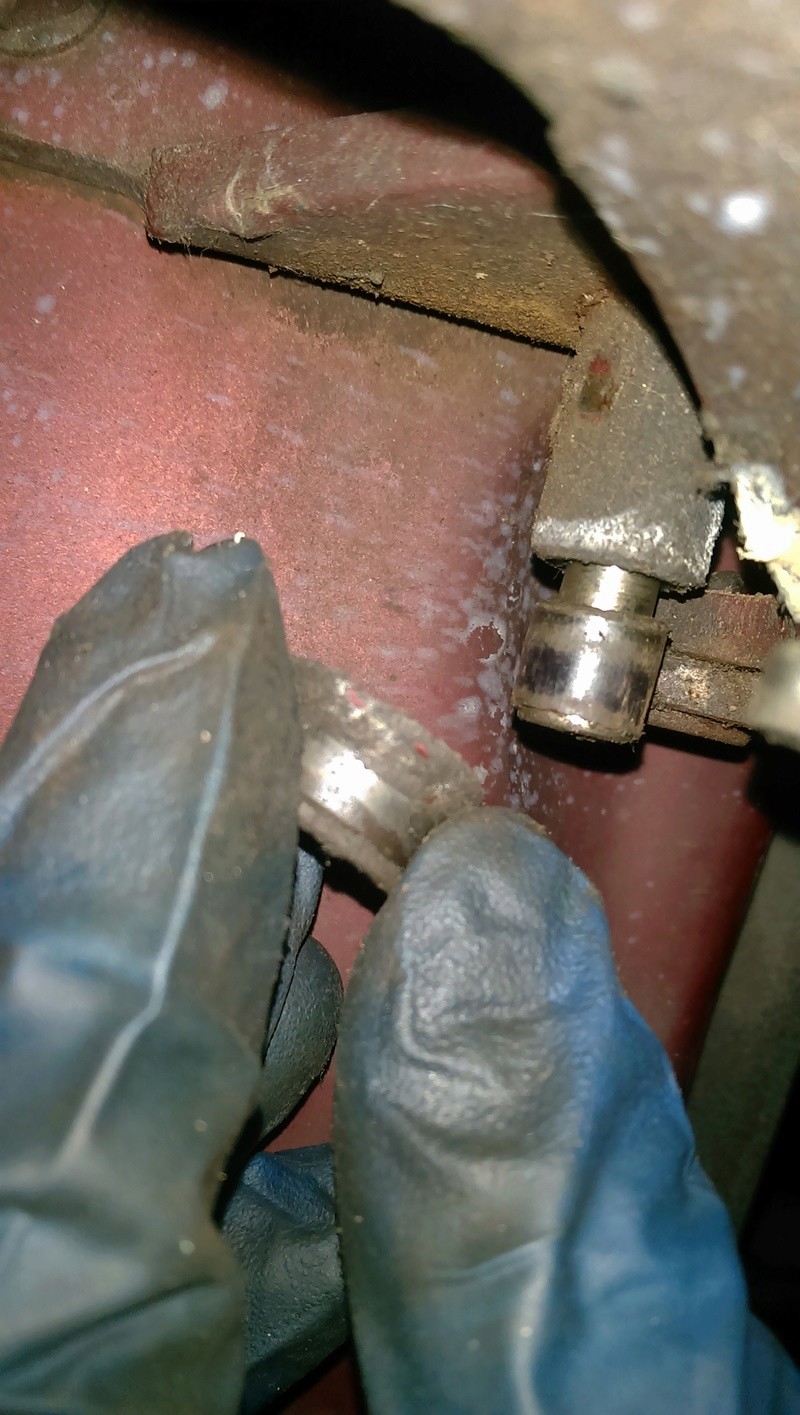

I have my passenger side door hinges completed, and I rebuilt them with all new bushings, and the roller wheel for the 2 open positions was nice and rolled straight so I left it alone. My passenger door opens and shuts like a dream! Just a slight 2 finger lean on the door and it closes completely with a single, confident "rumphf." Very satisfying.
So I have moved on to the drivers side, and as I expected, things are in worse shape since this door got used much more. Take a look at these pics. After I removed the spring from the upper hinge, the roller wheel was real loose and I was able to just slide it off with my fingers. Looks like there is a plastic bushing that goes on the big pin, that is worn out/broken. My question is- Do you just get a replacement bushing for that wheel? Is there supposed to be something that captures the wheel at the bottom of the pin, so it's captured? I'd imagine something like that might not be necessary, since the wheel is kept in line to roll by the sweeping follower.

Kevin they used to sell a roller rebuild kit. Haven't seen one in awhile though. If you can't find it let me know I have spare hinges with good rollers

Thank you! Looks like I probably only need the split metal retaining ring and the plastic bushing underneath the roller if your spare hinge has them. Lemme know, thanks!

Here's a solution for the roller issue.

Thanks yes I did see that kit, but I was trying to avoid that one since I'm only in need of one retaining ring, and perhaps one roller bushing.
