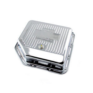

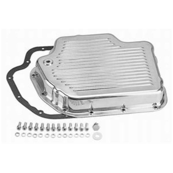

Post by 1973montec Sat Jan 14, 2017 2:10 pm
350 square with corner cut off

400 looks like a boat

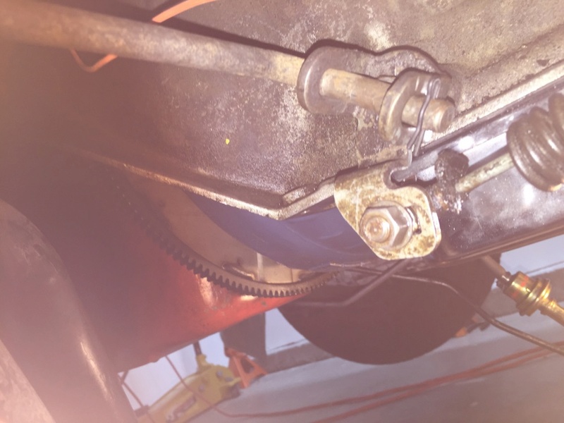

Post by Scott 73 SS Sat Jan 14, 2017 3:49 pm
This is what I have is any of it correct? I'm checking to see what OPGI hasAutomatic shifter installation 73 chevelle Img_2023
