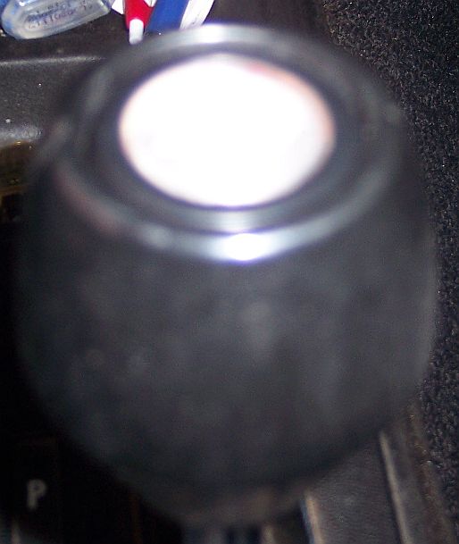

My 74 has an automatic and console set up. It was missing the snap ring and clip in the knob and button for the shifter. I ordered these. It has the ss button on top of the knob. It seems that the button still pops out of the knob when in park for an unfinshed look, but it stays down in the knobe when in the gears. Is it commom for the button to pop up out of the knob in park

Not sure if you are describing that the button comes all the way out when in Park. But, it's normal for the button to protrude maybe 1/4" above the knob when in Park.

park button sticks out of knob![Automatic console shifter button queston Bpark10](https://i.servimg.com/u/f29/12/69/99/95/bpark10.jpg)
drive button is flat with knob![Automatic console shifter button queston Bdrve10](https://i.servimg.com/u/f29/12/69/99/95/bdrve10.jpg)
first button is resest in the knob![Automatic console shifter button queston Bfirst10](https://i.servimg.com/u/f29/12/69/99/95/bfirst10.jpg)

yea it seems to come out may be 1/4 inch or just a tad more in park.....sometimes just a little bit to see under the button. So basically it is supposed to pop out some in park, fluch in drive and recessed in 1st. I did not know that. The shifter does shift hard and I have ordered a new cable for it. Would that cause it to maybe pop out a little more than normal?

Just checked the one on my '77 and it's right near 1/4" in Park. Same with the spare I have without a cable. Despite a sticky cable, when the shifter is moved into the Park position, it allows the shaft (it's spring tensioned) to snap upwards into a deeper notch than in the other positions. This is why the button sticks up further. Could the clip with the two protruding shafts that goes into the bottom of the button not be seated entirely? If it's after-market, could it be slightly longer than OEM? When you installed the button, did you make sure those protruding shafts were pinched and seated properly down against the shaft? Can't think of any other reasons.

Ok I think I figured out the issue with the button. After looking at the abouve pics it seems like actual black knob is different than the one pictured about. It is slightly different on the bottom....maybe this is the probem and if any one has one I will buy it. Also I think HDHugger is correct that the bar needs some welding or looking at....it moves more than an 1/8 in...it may be more like an inch or two. Thanks for all the help...and if anyone has that knob I will buy it. Thanks!

my knob is a "73" only knob 74-77 was more egg shaped (rounder)
