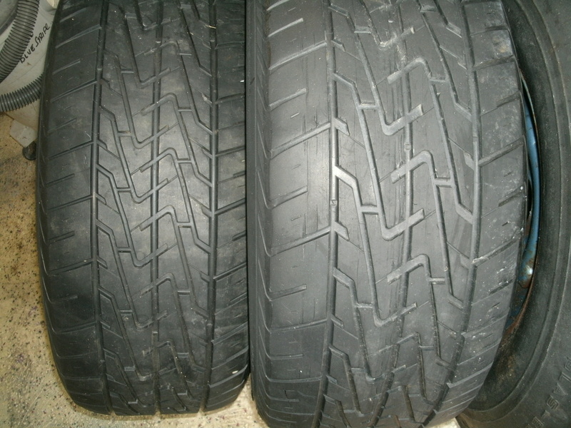

Yesterday I stumbled upon a guy selling some 275/60r15 tires. Took a look at them and they were real clean. Made a deal for $25 for the pair. I just wanted them for "rollers" since I still have some 3/4" ply tires out back and they are getting flat spots. LOL. And tires would work much better with my car dollies to move the car. I decided to mount them on my 8" centerline auto drags.

I mounted up the tires and put them on the car. Also wanted to see how she sits with the new suspension anyway. Car sits level but theres still no engine in it. So it should have a slight rake when done.
Real happy with the setup. When the time comes, I have two models of tires in mind when the time comes for permanent rubber out back. I already put brand new fronts on, 205/75r15 on 5.5" Auto drags. They actually come in with a narrower section width then my 3.5" auto drags I removed. So they appear skinnier.
